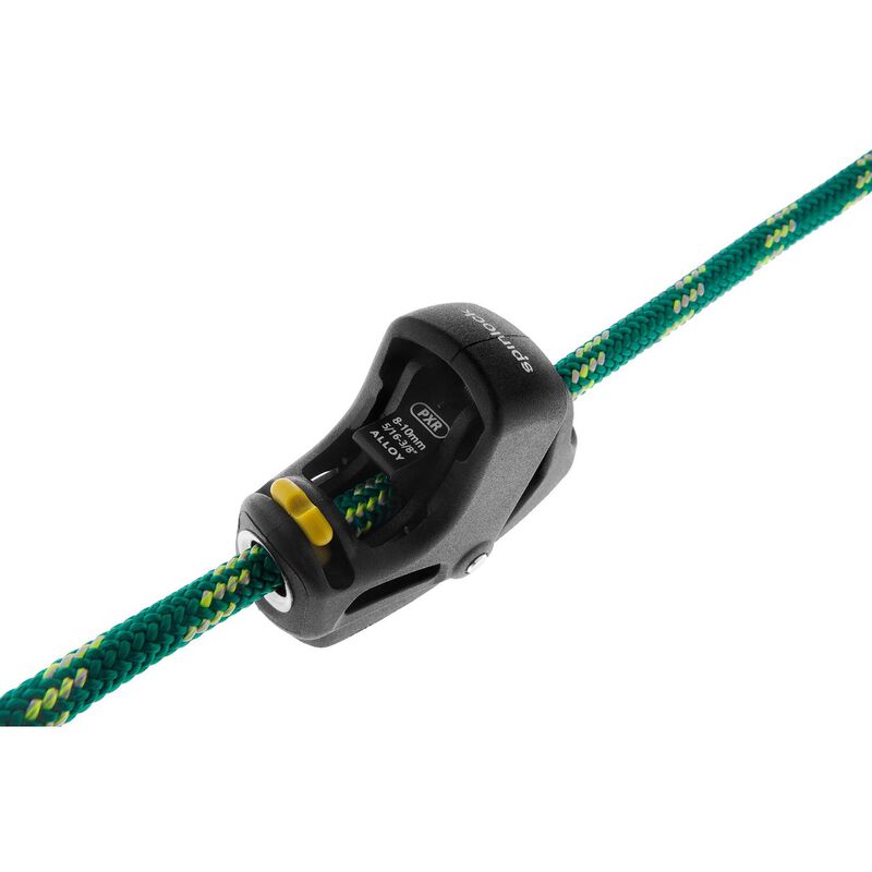

I bought my boat from Blue Water Yachts and as part of their "lines led aft" package they used these spin lock cam cleats.
I LOVE them. Mostly because I can operate them from behind the wheel by simply yanking them up to release. I don't have to move to the cam cleat and move a lever.

Another +1 but I use these on my jib sheets. Just flip up to release and flip down to lock once the jib is in the right spot.

I saw those. I like the idea of easy release. But are they strong enough for all uses? Like for the halyards?

YES!kenfyoozed wrote: ↑Sun Nov 05, 2023 1:23 pm I saw those. I like the idea of easy release. But are they strong enough for all uses? Like for the halyards?
I have them on my main halyard and daggerboard line. Very strong and easy to use. Pull straight out and they are automatically in lock position. This allows me to use my winch to pull the halyard tight and the clutch is already in the locked position. Unwind the winch and they are tightly locked.
To release, simply yank the line up and the clutch releases the line.
See winch is behind the spinlocks. BWY did a great job rigging my boat.

Never tried it on a halyard but I have to assume that the tension on the jib sheets in a good blow have to be greater than the tension needed to keep the main or jib raised. They have held my jib sheets through winds that ripped the clew out of the jib and another that put the boat on its side and spun it. I think they will keep your halyards where you put them.kenfyoozed wrote: ↑Sun Nov 05, 2023 1:23 pm I saw those. I like the idea of easy release. But are they strong enough for all uses? Like for the halyards?
