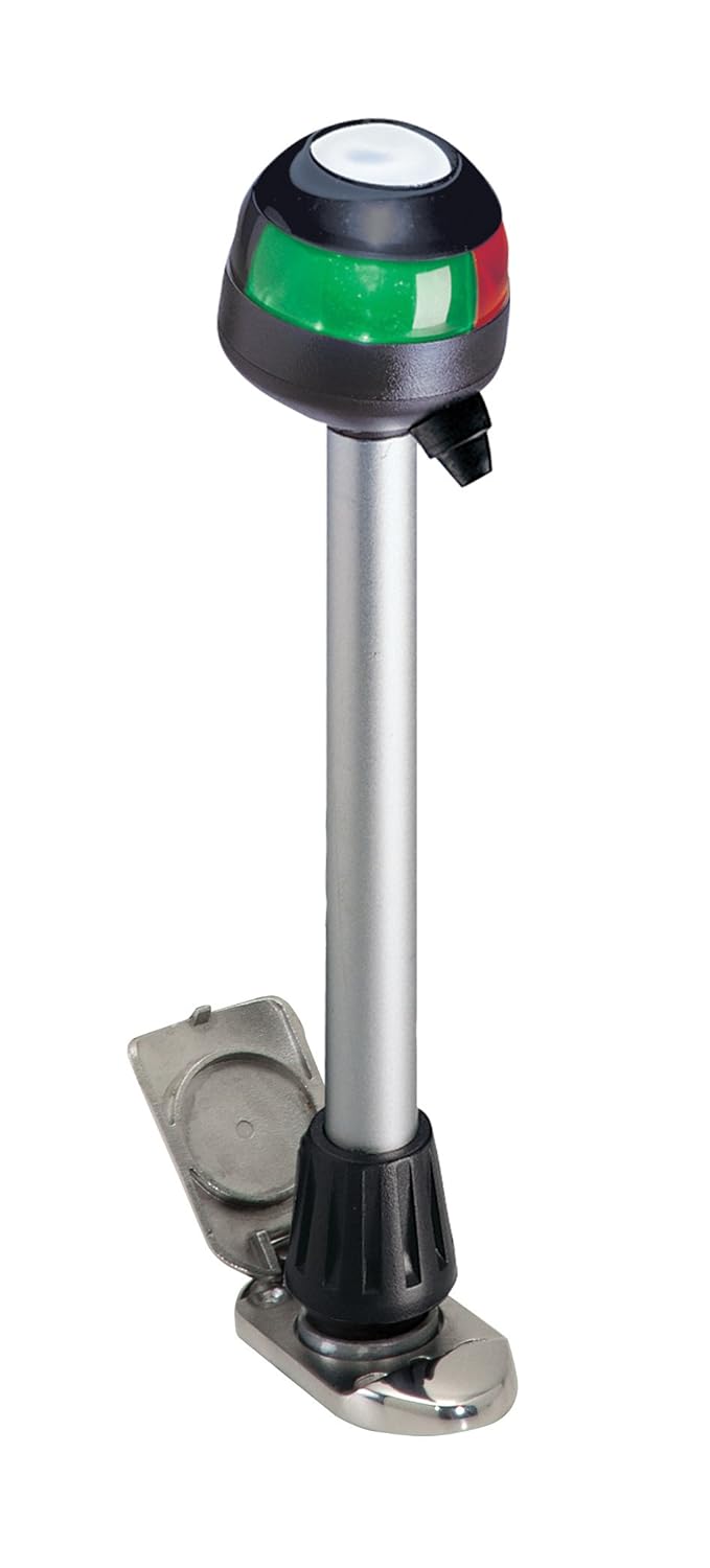

And yes, you will have to relocate the bicolor sidelight unit, but maybe you could put it on a spacer. There are hanger brackets for bow rails. Or use a pair of them, one on each side - I've seen at least one boat with separate sidelights on this board, though I don't recall who did that.
