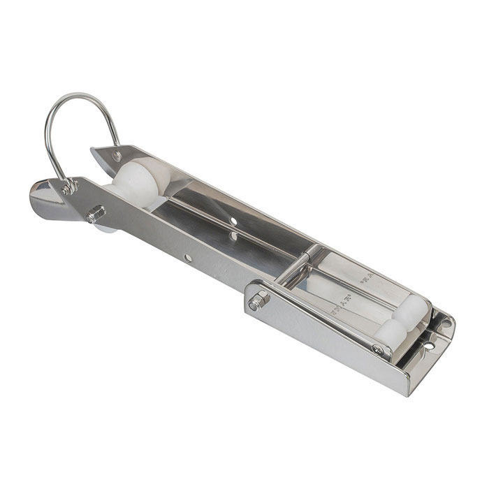

Here is the pic of the roller...it is pretty big and beefy..to go along with the big and beefy new anchor.
I'm hoping to make a cruise down to the Keys in a month or two and give this new anchor a proper test.

Is the problem only when roller hinges and flips up? If so what about just through bolting it flat so it does not hinge and running it straight forward... I know it would defeat the feature, but I can't envision the hinge being all that necessary since you will be up there retrieving it manually. Possibly even a nuisance while securing the anchor since there is not a windlass keeping tension and the hinge held down. With it fixed solid seems you could fine tune the roller location to where it would work on a mac. Also, how does the overhang proportion seem with only the hinge pad on the bow and anchor in the roller?
- Dimitri-2000X-Tampa
- Posts: 2043
Re: Anchor Roller Installation
It seems to have plenty of overhang and does have two holes to change the overhang proportion but I think I would leave it in the current setting which is maximum overhang. Best to have less chance of a swinging anchor impacting the hull during retrieval.
So originally I got the hinged one for a few reasons..like the back roller, and the fact that the base was pretty small compared to the roller so that I could get maximum roller on the tiny little 26X bow. Then, as I realized that I had to move the furling line to the port side in order to install the roller, I came up with this cockamamee idea to use the old furling guides and pulley as an anchor release line, my 25 foot floating 3/8 double braid will be attached to the little anchor reverse pull hole on the shank, so it could even free the anchor if it ever got stuck under a rock or something. So you see, with the hinging, the anchor can be self dropping. I can take the safety off of it and then as I singlehandedly back into a beach landing, I can drop the anchor from the cockpit like that.
So, if I put it relatively straight off of the bow, it won't "hinge" much anyway before the top part hits the furling drum and stops. The further I angle it away from the bow and the more that it clears the furler, the more it will drop down in the hinged position. In order to have the full hinge movement, I probably have to angle it at least 35 degrees off of the point of the bow...which I was trying to avoid...not to mention the fact that the base will have a smaller bolt triangle to bite into the tiny bow triangle.

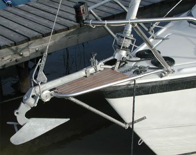

- Posts: 5995
maybe adding a bowsprit like this pic & adding it onto it !
http://i78.photobucket.com/albums/j95/m ... /deck2.jpg
Hope this gives u some idea,s

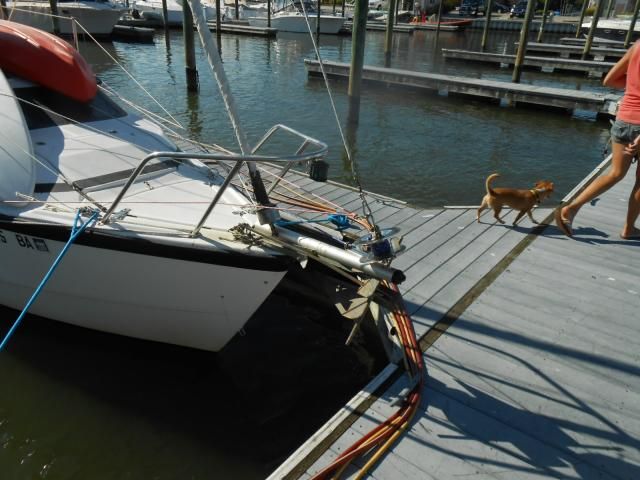

Should work, pick the best compromise location.I guess I need to dril one of the rear holes first, bolt that on loosely and then move the roller (pivoting on the one bolt) until I get it right where I want it angle wise, then drill the last two holes, one which will also go through the metal of the roller base.
That is funny, I take my mast down once or twice a year and the only close pic I had in my photobucket is with it downit seems most people post pics of their rollers in the trailering position, with no furler. So its very hard to get an idea of how others have solved this problem.
I am contemplating some changes and a new roller. This is the setup we have been using this year. Drifter&Spinnaker furler sprit is bolted to the anchor roller and also through the extra hole in the forestay tang. I have also messed with a longer sprit from 3' back the deck. The anchor regularly goes underwater while sailing when the waves are steep, I would not want the anchor weight any further out. Last weekend was rough so I pulled the anchor completely off before we left the anchorage. Even with it off the sprit furler was still regularly plowing into the face of waves when the boat slid into a trough. I am liking the furler up there though which is why I am thinking of getting a beefier roller and re doing the whole front end.Good advice..although can't see someone ever "replacing" a roller once its on there.
I also figured I would relocate the starboard cleat right behind the furler (in between the roller and the port side cleat) but now that I see restless setup, I wonder if I should put it further back...although I don't know how accessible that area is from below.
Its tight but workable in there. While in there maybe put on some extra cleats, get it all done at once. (nice if you use a bahama moor) Will your line run direct to the cleat (makes location important) when anchored or are you trusting the roller with the full load?

Looks like both of you (Seapup and Highlander) have really nice setups with Sprits, extra forestays/sails/ets. Maybe one day I will get that ambitious but for now, just want to get the roller on there. Ended up getting too busy this weekend, not to mention a heck of a lot of rain in these parts. So maybe I will ponder over it for another week...a little extra time is always helpful in making the right decision before drilling. I'm going to go out there now and scope out the compromise position and see how it looks.
Regarding cleats, in that one pic (before the sprit), it looks like you have 4 on there. And you even seem to have one on the outside of your roller so that must be a really narrow roller. Mine must be close to 4 inches wide so that might be both good and bad. The place I was thinking about relocating my removed cleat to is about where you have a fairlead in that same pic...it would be a bit cramped, but should still be functional. Just eyeballing my vberth, it seems you would have to cut an access panel and go through the flotation compartment to mount those further rear cleats (same with those extra big cleats on Restless - which certainly do look nice though). I have adopted a (apparently age related) philosophy lately that I want to be out sailing my boat a lot longer than I"m working on it. I remember my O'day, man, I worked on that one far more than I ever sailed it...it seemed..
Anyway, that is why I try to minimize the amount of work for extra stuff (scope creep) although I do certainly understand what you mean by getting it all done at the same time for better economy of scale...and maybe one day when I'm also not working, raising a family..and now also taking grad school (man, all this stuff is seriously cutting into my sailing time..lol), I could get to some of this super cool stuff you guys are into.
As to your question about the line running directly to the cleat, I don't quite understand the implication because I would have thought that when you do run the anchor rode to a cleat, you are in fact trusting the roller arm with the full load. Maybe I would do that for a lunch hook or other temporary anchoring. But for overnight and with any wind, I bought one of those shockle things (I think that is what they are called) that is like a 2500 lb short bungee cord that I can attach to the lower bow eye (the one you use to winch it on the trailer) and then intersect the rode with this little loop line that they sell with the shockle. I saw some people using setups like that the last time I was in the Keys so I've bought the stuff to emulate it although I haven't tried it yet. But with that setup, there won't be any stress on the roller. The shockle will absorb stress from the rode (cause a 1/2 inch rode with chain seems a fairly stiff overkill for the bouncy clorox bottle that would probably be happier with a stretchier line) and the fact that it is attached lower down will put a better scope angle on the anchor as well. Here is the defender link that shows both the snubber and the line grabber...I can give a report on how all this stuff works when I get into serious cruising season on Oct/Nov seeing as everything is theoretical so far. http://search.defender.com/?expression= ... Trigger=ac
