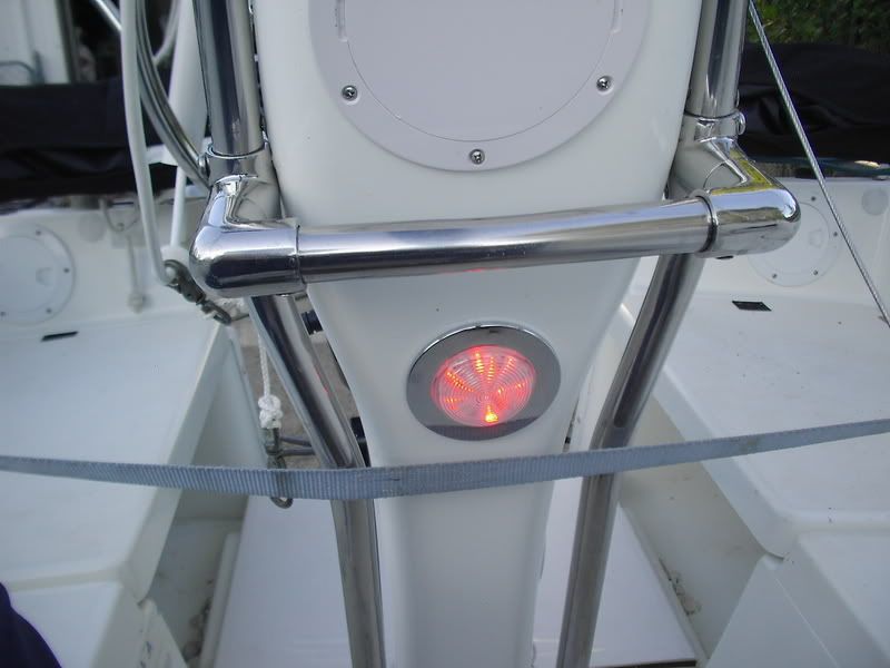

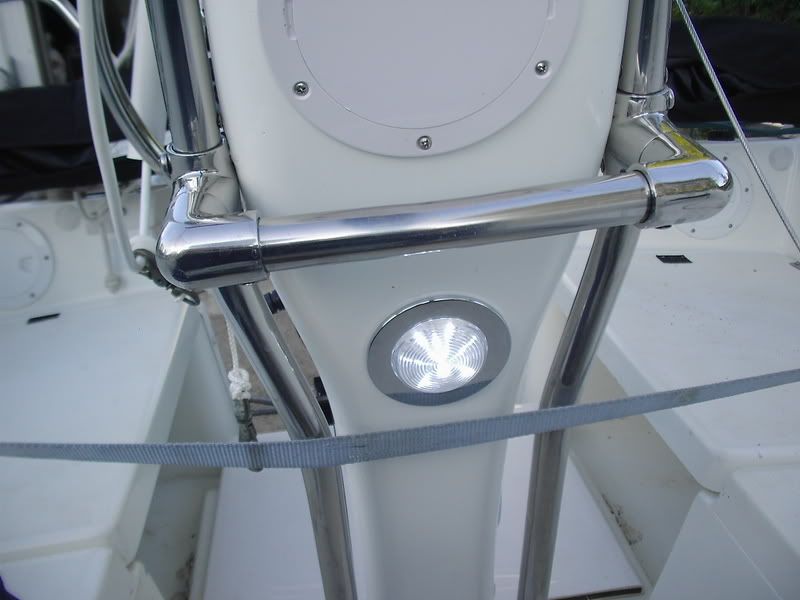

Nice looking bar around that pedestal. Welded or not? How'd you bend 'em?

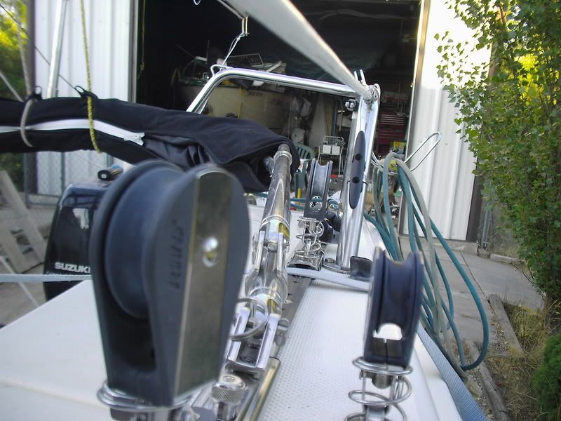

No the swivel power cleats mounted on the cabin top rails are for my furling lines "cutter rigged" will be used for sailing only their is back up cleats mounted on the stern rails for powering & prevent the furlers becoming undone during inclement weather
I'll take pic's of all the running rigging this wk-end & post she looks like a busy deck but every thing is well planned for singlehandling
the pedestal guard is 4 pieces of 1"ss tube one "U" shaped top, two legs , one handle , 2 "T" fitting, 2 elbows , 2 ss 7/8" x 3" tube inserts & 2 bases all put together with ss hardwhare & ss rivets
The handle will also double as a support for a snap on cockpit table to be made yet

Yeh I know what you mean about the hose clamps but I want to try these power cleats in that position first before I drill any more holes in the boat I also thought of mounting them on the cockpit genny track when I find the best location then I'll make something more pernament
As for my two #2 cdi furlers I just bungy cord my bigger boat hook & whiskey pole as they seem to be called on this "site" on each side of the mast then bungy cord the furlers to them
Now as for my new cdi spinn furler & 350ft spinn no problem I just "bag it" is'nt this amazing
