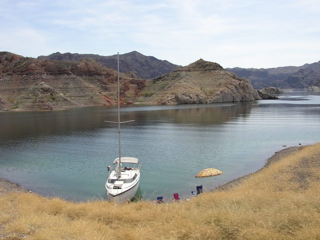

Just a tease. Lake Mead Spring Break 2007.
[/img]
I would definitely go with the keelguard. Mead, unlike Powell, is very gravelly and I came back with quite a few nicks and gouges. I used one shore anchor and just buried the danforth for the second anchor. You need two anchors and tie them off at the stern at about 45 degrees.
