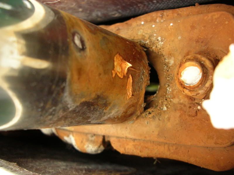

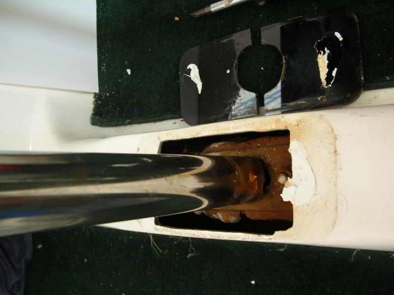

I have suffered corrosion damage to my compression post and am replacing it. The damage has left a 2 inch hole from the cabin into the centerboard trunk - when sailing at 15 degree heel or more it admits water, and when heavily loaded forward it drops below the water line and lets water in in a constant stream.
I contacted Bill S at the Macgregor factory who is pricing the pole and a procedure to replace it. It attaches with 4 bolts up top, and two on the bottom. I hope to be able to wiggle it out without cutting the liner, but if not I can make a cosmetic cut under the table which will be easy to fix. Im planning on making two vertical cuts and then bending the liner to let the pole slip out, the Fiberglass the inside of the liner to strengthen it again if this route is needed.
Pictures of damage
Up close
My compression post is almost half gone at the attachment to the plate

That looks like a major safety issue. I sail primarily in salt water and am very concerned that this could be happening on my boat without me knowing it.
How do you think it happened?
Any suggestions on how to prevent it?

Minutes after reading the original thread concerning this aweful structure failure, I checked my "X". I pulled the plexi plates, and gave a thorough look-see. I notice that the weld is secure, the silicone looks good, no fiberglass cracks, and so far Okay. The factory weld couldve been a little heavier duty in my opinion. No cracks, so far.

This damage is almost certainly due to stray current in the marina where I was slipped - I dont think my electrics were the source.

I'm still puzzled by this electrolysis, since the post is above the waterline while resting in the slip, right? In fact, I'd guess you had no metal in the water, though you might have had a 110-charger hooked up.
  • - Care to theorize on the potential path(s) of this low voltage?
    - Could this stray current have impacted the outboard or its alternator?
    - Would an isolator or AC/DC bonding have helped?
    - (is that a Classic Rock fan club?)
I've often pondered that the motor is a non-issue, since I always leave it tilted up from the water. OTOH, it's not a giant stretch to imagine forgetting to lift it some Sunday evening!

if the problem was not as a result of cathodic action then i would be looking at power finding a path to earth
spark errosion comes from electricity arcing across a gap
for example,in switchgear there are no right angles in the metal work,all corners have a rounded finish to prevent arcing
what i cant get my head around is "where did the power come from"
i can surmise that electricity will follow the path of least resistance and end up straying down the centerboard
are there any electrical cables running down the compression post?

In addition to all the above comments, you've also almost always had your boat in fresh water, right? I've always thought of galvanic corrosion as mainly a problem in salt water where the conductivity of the water is so much higher.
I think the Mac factory should pay to have the base of your compression post analyzed to figure out exactly what caused the problem.

When the ballast is full, and the boat is in the slip, there will be bobbin' around. Water levels in the centerboard trunk will be close to, or touching, the two bolts holding the compression post plate (and more likely if the boat is loaded with storage stuff). Im assuming the 2 bottom bolts go completely though the centerboard trunk, and are exposed to the water under the boat. That likely would be the only water and metal connection available if the engine is kept in the "Up" position.

I am no welder but the weld doesn't look like it was hot enough for that plate! Plus other possibilities, mismatch of SSteel grades between post and plates and or wrong grade wire used to weld with, not to mention a bad weld. I wonder, have you checked for any debris in the area? Like maybe the weld just flaked off, may have fell into the boat or out through the hole it left. I have seen some bad welding cause similar problems.
Maybe a welder out there will enlighten us! :o
I talked to an expert in welding I 'happen to know' (its cool having a database of 6600 people including 10 Nobel Laureates) and his analysis is classic bad weld - even told me the honeycomb effect that looks like electrolysis is the erosion of ferrite domains from a botched weld..very common in SS to SS welds if temperature is not managed correctly.
Stray current in the marina still doesnt make sense to me as there is no grounding path on this puppy, so my theory might be changing.
