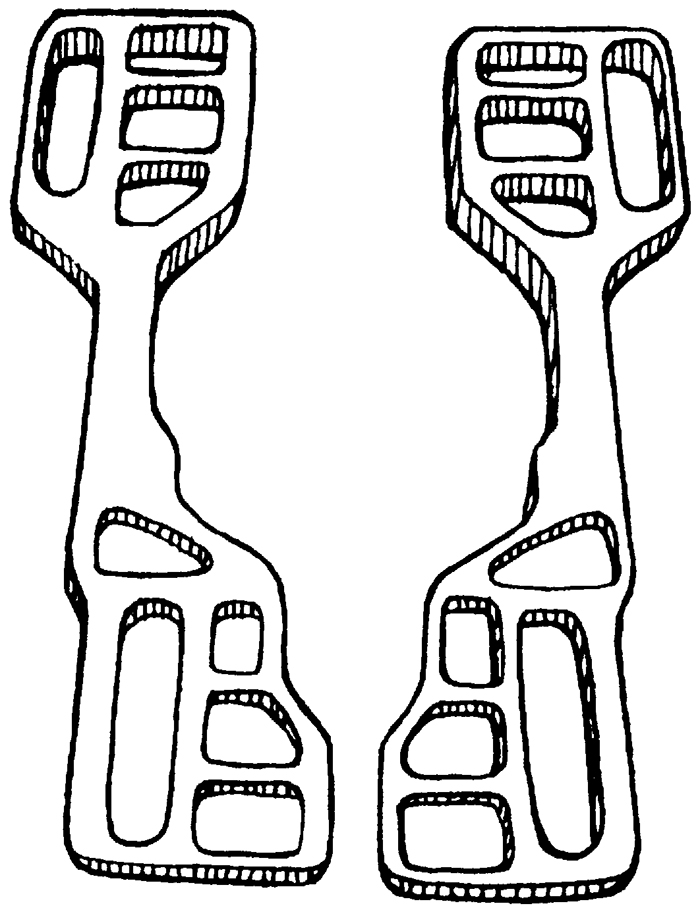

These???
i suggest that you be very careful installing reverse wedges for the purpose of gaining "bow down". the following is a paragraph from a lawsuit which talks about the dangers of transom wedges:
Michael Davis' attorneys, Chris Roy Sr. and John Bennett suggested the engine (200HP) was too large for the 20 foot boat. They said the transom wedges dig into the water, making the bow go down, creating sudden turns. An additional passenger was ejected with Michael Davis. Michael Davis was struck in the head and neck by the propeller and remains totally paralyzed. Various accounts differ on when and where he was struck. One report has him struck in the arm, another in the head and neck. One report has him struck "when the boat came back around", another has him struck when he entered the water.
http://www.rbbi.com/invent/guard/propg/ ... keeter.htm
Transom wedges are for "high performance" and racing use.
IMHO, a Mac is not the type of boat where transom wedges are necessary or should be used. but if installed, be careful.

Mac Ziggy
Posts: 116
Joined: Mon Mar 13, 2006 7:21 pm
Location: Barnwell, SC, 07 26M, ETEC 90
Post by Mac Ziggy »
I don't want to do anything to make the boat unsafe but something is not right. Between 19 and 22 MPH I get what I call the M Splash. Water comes up through the dagger board slot and sprays the cockpit (and interior if the hatch is open). At about 15 to 16 mph the boat cruises fine but when I add more power the bow starts to come up. At 19 to 22 the M splash. If you can get past that you can get to about 25 mph.
I spent 5 hours on the river yesterday trying different approaches but always got the same results. I also developed another problem. After plowing water for a while, I switched tanks and the engine would not start. The starter would not engage. Cooled down while I was trying to figure out the problem and started right up. Ran for about an hour, turned the engine off and it would not start. The starter spins but the bendix does not engage. Waited a while longer to cool down. Started right up. Never got any engine warnings from the command system. I will call my dealer tomorrow. I think all that plowing put a lot of stress on the engine. It could be an electrical problem.
It seems like the bow on an M has a higher profile than an X. I will add some weight to the bow and do some check rides before I change anything.

FWIW, Gene Arena was the Mac dealer from whom I purchased in August of 1999. At that time he had already been selling Macgregor trailerables for 25 years, ever since Roger's first models. Gene was also half of the Arena hydroplane racing team in the earliest days of that sport.
Gene always was more of a motor guy than a sailor. In the quest to maximize the benefits of the earliest powersailers, he was first to mount the Merc Bigfoot, recognizing the benefits of larger, pontoon style props. When I offered to buy a 26X, but only if he would install a bigger EFI motor, Gene agreed with one proviso. He refused to sell me an oversized outboard ... I had to go out and buy the motor myself.
And, he insisted on installing it, his way! That, of course, was fine with me. I was convinced of his qualifications by seeing his work and just by listening to his logic. Gene insisted that a wedge, larger at top, was needed on the 26X transom, to take advantage of the outboard. He had a custom aluminum wedge fabricated at a machine shop ... I'm not sure if they were available then at retail, or if he just wanted his own design. He also insisted on installing interior transom reinforcement. (My interior transom pix are long lost, but I'll snap some new ones later this week.)
I'm sure that Bob's advice is valid too, allowing for the scales of comparison. That article discusses 200 horsepower on a 20 ft boat. We're mounting 100 hp, or less, on a hull that's probably twice the weight of the runabout.
Of course, my Suzi-60 never gets out of the hole so there's zero potential of burying the bow. She is eminently stable in straight-line or a hard-lock turn. Geoff's boat seems to be on top of the water ... caution is appropriate. If I was thinking of upsizing beyond 100 hp, I'd take the time & the trans-cont flight to North Carolina, and beg a ride in Billy's 140hp Mac 26X.
