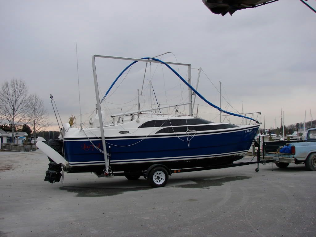

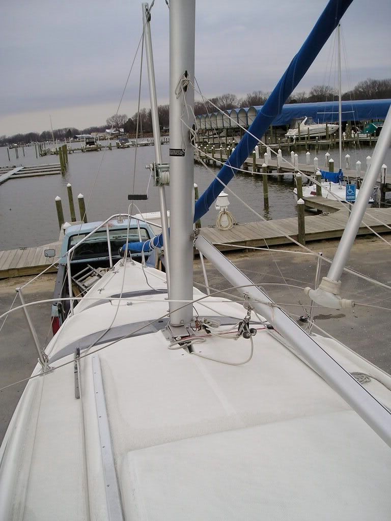

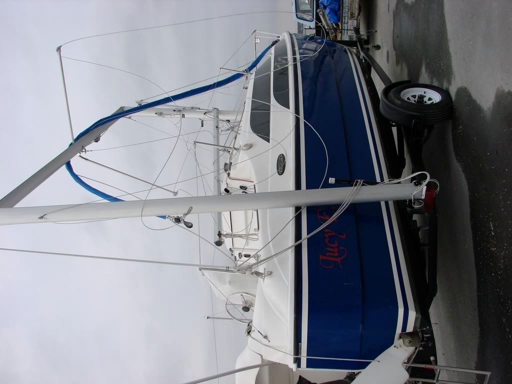

I keep Lucy E. in a slip at the Colonial Beach Yacht Center, overwintering her on her trailer at the marina, generally works well. Yesterday I received a call to let me know that a contractor dredging and moving spoils around the marina too down a power pole which managed to snag my mast on the way down, bending it every 10 feet to a 90 degree angle, thus leaving the boat with the appearance of having been stapled.
[Image
ImageFrom what I could tell, no damage was done to the boat itself, no crazing of gelcoat or tearing of glass, and the rigging appears intact. I have placed a call to Otho Campbell of New Millenium who sold me the boat two years ago to see what arrangement could be made for someone to inspect the vessel and provide an insurance estimate prior to undertaking repairs. At the very least it looks like a new mast and a delayed boating season.

Much stress was placed on the boat where it and the mast connect. Check out the deck at the base of the mast real well. Also check for cracks where the bunks and the hull meet. I don't know how long the pole pressed against the mast before she buckled, but a heck of a lot of pressure was put on the boat. Make certain the the mast was the only thing that gave way.

The downward load on the mast would have been transfered through the flexible top deck to the support below which would press hard on the hull below that. I would have a careful check all the way down to the outside bottom hull to look for damage.
Also, maybe the whole boat bounced around on the trailer and then came back to rest, so look for hull vs. trailer marks too.
From everything Ive read about Boat US, I think you will find they will cover you on the issues above well
New mast
Check step for damage
Check hull for damage
Get new mast to you stat for the season
