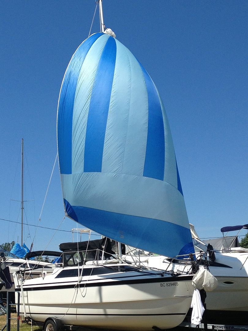

We've been mast up on the hard for almost 10 years in a locked compound at the marina.
Best of both worlds, but as always ... a compromise;
- lower rent and only temp anti-foul paint
- but still slave to the tide for launch and weekend warrior gong show pulling the boat out after a long trip.
Mast-up; almost fully rigged during sailing months
Mast down; fully cover winter months
