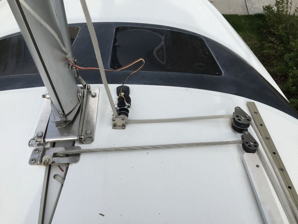

Re: Clam cleat for halyards?
I installed a pair of Harken 140 Pivot Blocks with cam cleat on my 26X for the Jib and Main Halyards. Easy install, pop rivet to the mast. No turning blocks. No additional cam cleats. I have been very pleased with it. The original halyards are long enough when the sails are down to reach from the cockpit at the hatch to raise the sails. Once raised the the ends are dropped into the main cabin. I do not have a furling jib but leave the jib in the front hatch to hoist. Lowering the Main is easy and I can toss a couple bungies around it to secure it for docking. I have always single handed the boat even with 6 people aboard.

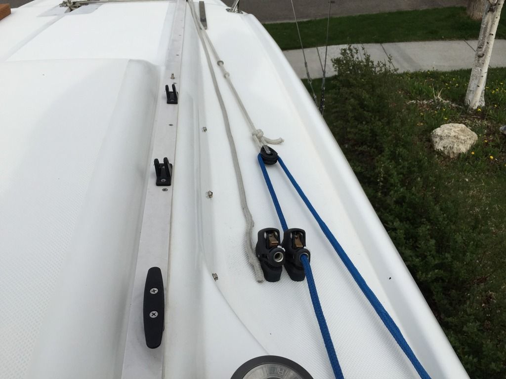

- Posts: 5995
When I ran my lines aft I kept them off & away from the deck floor as much as poss. to avoid walking on them
raised my winch cam cleats
http://i235.photobucket.com/albums/ee20 ... 010067.jpg
http://i235.photobucket.com/albums/ee20 ... 010066.jpg
2 swivel cam cleats on the mast base
http://i235.photobucket.com/albums/ee20 ... 010014.jpg
swivel power cleats for furling lines
http://i844.photobucket.com/albums/ab1/ ... 10/005.jpg
aft winches for genny & or spinnaker
http://i844.photobucket.com/albums/ab1/ ... 10/003.jpg
http://i844.photobucket.com/albums/ab1/ ... 0021-1.jpg
doubled up the foot blocks on both sides
http://i844.photobucket.com/albums/ab1/ ... 0015-1.jpg
7ft roof top genny tracks
http://i844.photobucket.com/albums/ab1/ ... 010008.jpg
power clutches in front of winches
http://i844.photobucket.com/albums/ab1/ ... 010043.jpg
hope u get some idea,s from this
