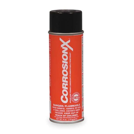

I have come to use CorrosionX for electrical fittings to keep junk out. Corrosion doesn't seem to be your issue if you have checked that.
