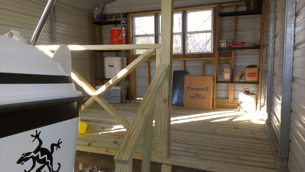

I'm happy to report that my "boat house" is holding up to the midwest winds and weather nicely :D
The elevated "dock" at the stern of the boat was a fantastic idea! It makes access so much easier!
