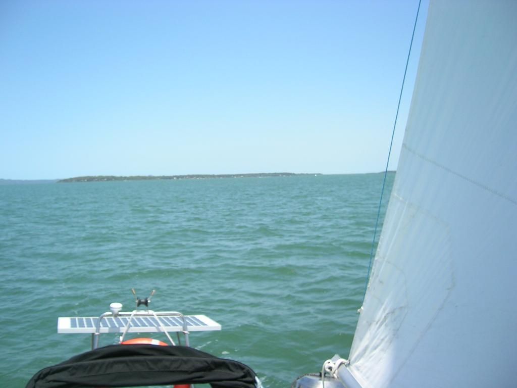

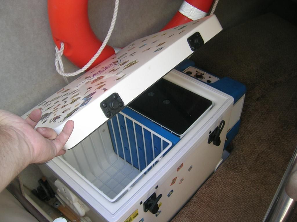

I have the Edgestar I think 48 qt fridge with 100 watt solar panel mounted on the modified mast support. Man I have to learn how to resize pics so I can post them.
Anyway the 100 watt does a pretty good job of keeping up with the fridge however we run the fridge during the day and turn it off at night when its cooler. Spent 1 1/2 weeks on the hook in the Keys this summer and had plenty of power to spare. Of course we don't run stereo, tv or any other luxury amenity but had the VHF and lights on without worrying about consumption.
