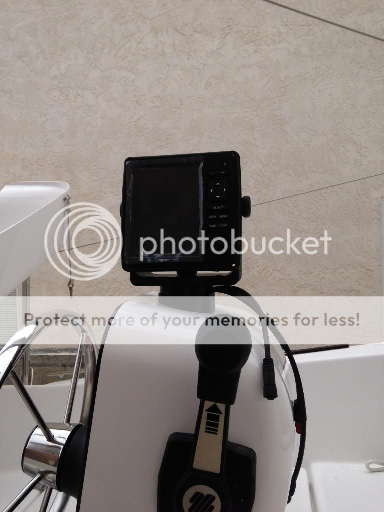

Well, nearly breaking my back on those slippery aft hatches I finally got all that chart plotter stuff done – The installation of the chart plotter and the NMEA2000 network, wireless, and Bluetooth was all very easy by just following mastrebs instructions – if you do everything mastreb says it’s really easy and also as mastreb said you can indeed put the entire NMEA2000 backbone network inside the battery compartment – here is a picture of it in the battery compartment:
The only thing about the chart plotter install that I did not like is the angle of the wheelhouse. I tend to sit off to the side and let the helm take care of itself a lot so I actually seldom sit right on the helm seat. In fact – even when I’m docking I usually STAND behind the helm, and docking is pretty much the only time I actually get directly behind the helm unless the water is really really rough (and who needs a chart plotter for docking?), Normally I tend to bounce around in front of the wheelhouse playing with lines and stuff and I occasionally reach back and correct the wheel as needed. So imagine my consternation when I used that nice swivel mount to face the chart plotter towards me for the first time and this is what I saw:
My God! The whole thing is tilting sideways!! Well, that’s just not going to work – so I thought about fishhousebarandgrill and his skills with PVC pipe and I fashioned a new mounting base for the chart plotter like this:

That’s better! Now I can see the chart plotter at the right angle no matter what way I swivel it:

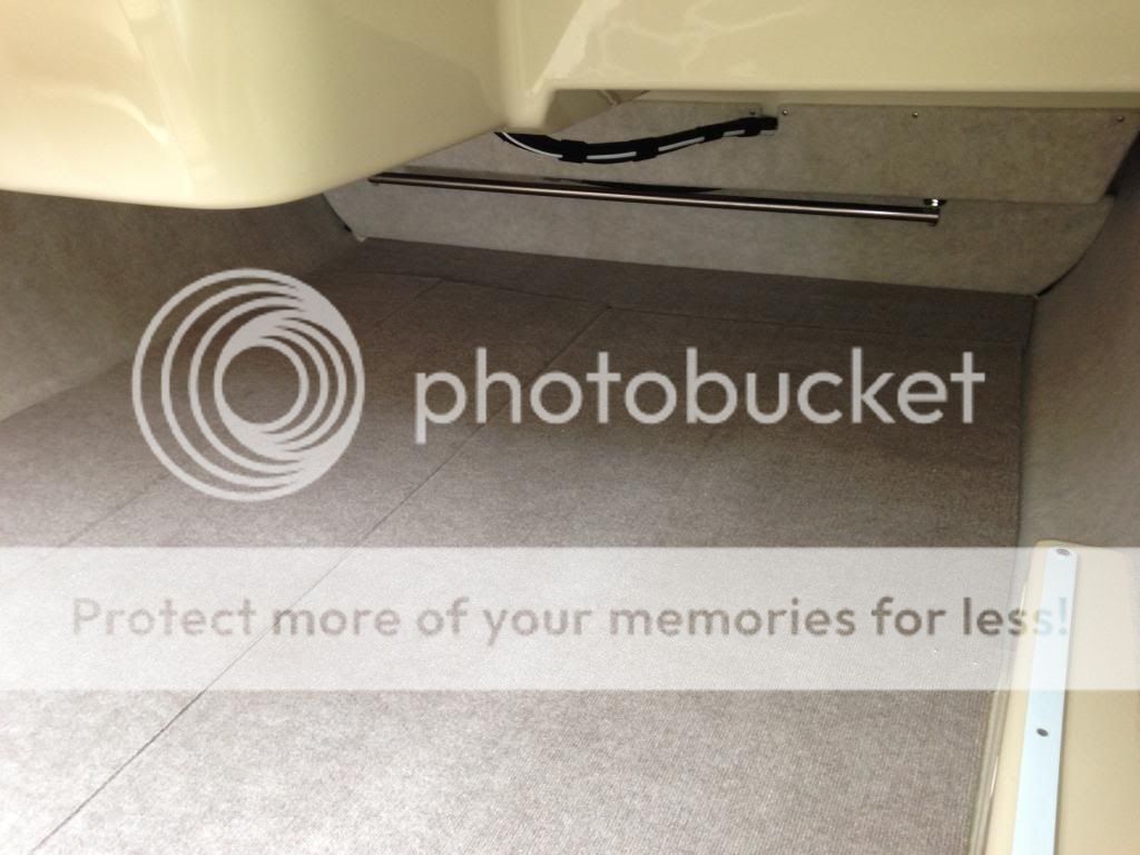

Using wood that is thinner and lighter than the stock PVC hatches but about 7 times stronger I made this:

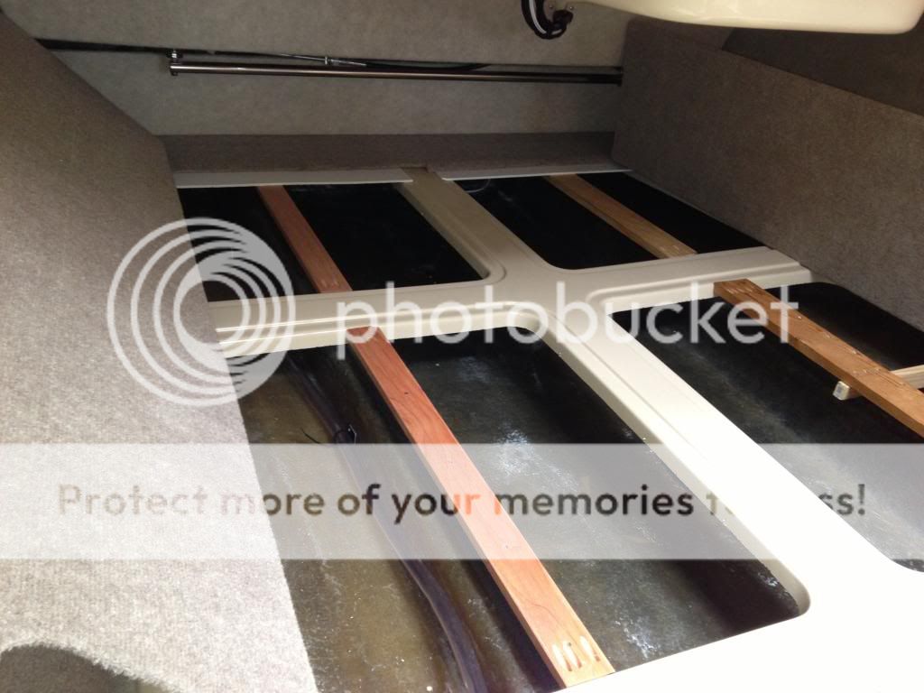

And the whole floor articulates into an open position to give free access to the bilge – I did put stiffeners over the ballast humps – they are actually attached to the liner – they don’t really rest on the ballast hump:
That made a HUGE difference when squirming around back there doing wires and stuff, and you can lift open one side and lay on the other side they are covered in carpet similar to the hull carpet so it's comfortable to move on even on your knees - the doors can also open one half at a time too (they hinge in either direction at every fold) - it works.

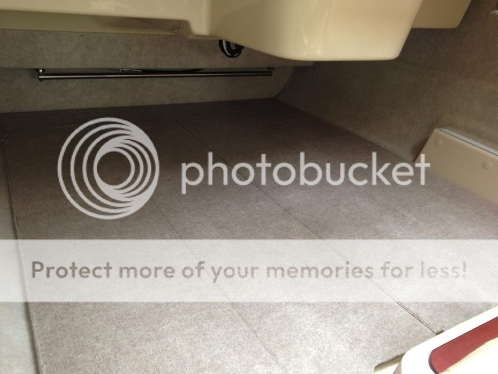

What I like about these new hatches is that they are attached to the boat with hinges way over on the port side and the starboard side, and the boards all fold in either direction so you can open only one board or two or all four. In this shot you can also see mastreb's "ballast vent to the rear mod" which really eliminated the odor from the ballast tank in the front and makes everything work at the helm seat:
The doors lay flat, are very light, and make an excellent working space if you need to do things under there, or even a nice play area for the kids:

I am one of those KREG JIG guys - I got that way from building my RV interiors (that's how the van conversions are made - with KREG JIGS) I used sand-ply from Ecuador, readily available from home depot. It's the plywood that has a veneer side so you can finish it if you like with varnish - the other side is a paint grade - the extra bonding of a solid front with a ply back makes it very strong but extremely light, I have used it to make doors and cabinets in my van in the past because when used as a skin on a frame it gives the illusion of being a solid piece of wood - that's the KREG JIG way of building stuff strong and light - if you want to go a bit stronger try a cedar veneer or even a mahogany THIN like as thin as the PVC stock hatches. Then I cover them entirely with headliner glue and WRAP them in carpet - the real light flimsy carpet also at home depot in cheap rolls. The carpet forms the hinges between the boards, and two simple strap hinges ties the whole thing down at the far right and left sides so the boards can NOT slide or move no matter how they are folded - they are anchored to the boat by those strap hinges. The cheap carpet does NOT stretch so it makes a good hinge. You can't open the part of the berth to the very rear because the doors would bang into the steering bars if you went all the way to the back so that short part to the very rear (the last 8 inches) is solid, does not open - but for access it's fine - I can reach around 8 inches easy. On that last 8 inches just make one solid piece all the way across and screw it down -
It does not weight much at all - I was carrying both folded carpeted port and starboard hatches under my arm as I climbed up the rear ladder into the boat - I could not even do that with all four of the stock hatches under my arm. Just make sure you use LIGHT CARPET! NOT heavy home carpet! The real thin light indoor outdoor area rug stuff. The entire roll of carpet was less than a pound. The only real weight I ADDED was beefing up the area over the ballast vents - I figure that's about 2 pounds of sanded redwood, (an oily wood as an alternative to teak) but if your a rich boat owner go for the teak - it's even stronger than redwood and LIGHTER. Ever notice how strong your companionway ladder steps are? That's cuz the're TEAK. (Even Roger was superstitious enough to know that you NEVER build a sailboat without at least SOME teak in the construction). Otherwise - it's not a sailboat.
