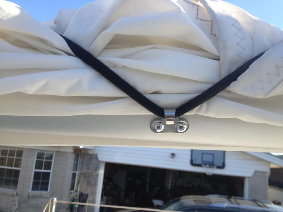

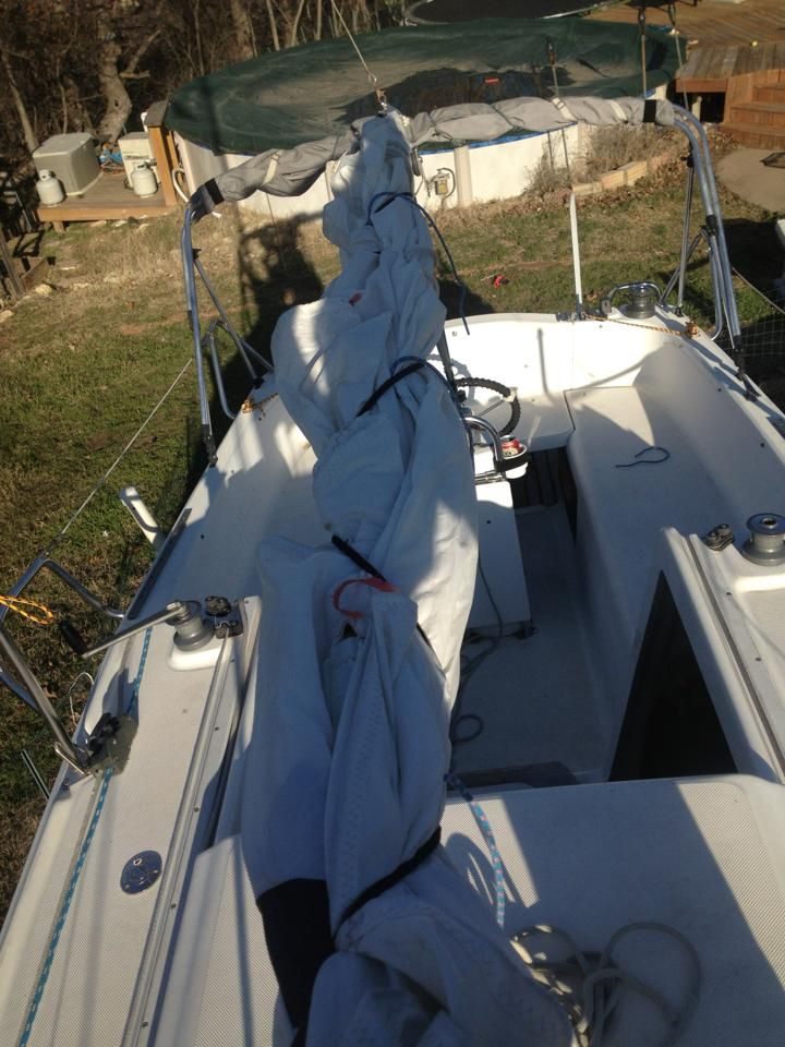

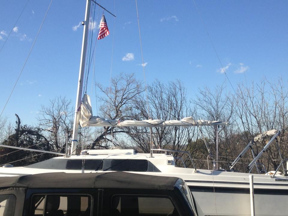

Flaking the main on a small bouncy boat is a bit scary for me also. I've looked into Lazy Jacks and other solutions. They probably work well, but seem to still need ties to hold the main down if there is a wind.
I found this mod on the facebook mac group. I'm stealing it. Simple way to have sail ties ready all the time.
Not my boat, but I'm stealing the idea. Run a long bungie cord along the boom. Use hooks to wrap the cord around the sail. Simpy easy and cheap. The way I like it.

Russ,
I like it :!: :)
Went I got my Catalina 22, it had the remains of this setup on the boom. The bungee was rotted away. I never put it back together, but have though about doing this on my boat for awhile. Sure would make quick work of securing the main, when doused.
Another thing to consider, could be to rig a simple downhaul. I've thought about it for both main and head sails. Haven't done it, but there have been a couple times I wished I had done one for the head sail, at least. It can be a real bummer, when you're up there trying to get the sail down (particularly the big head sails) and you accidentally let go (usually to catch yourself from taking a dunk) and the wind pulls it back up the forestay.
