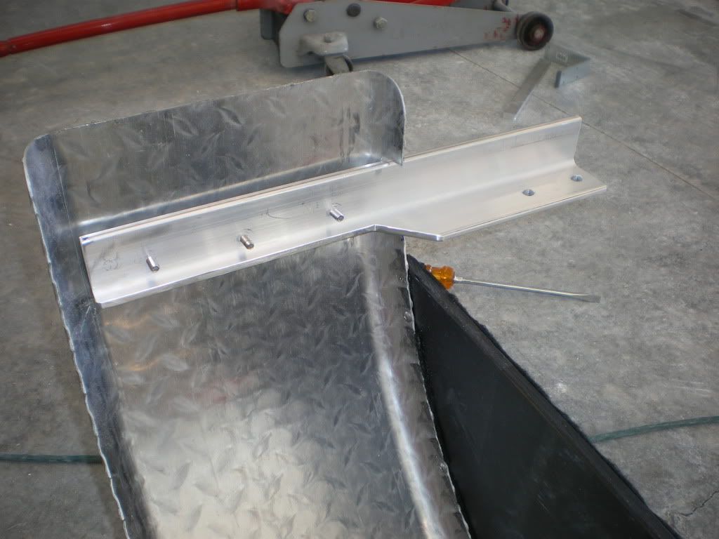

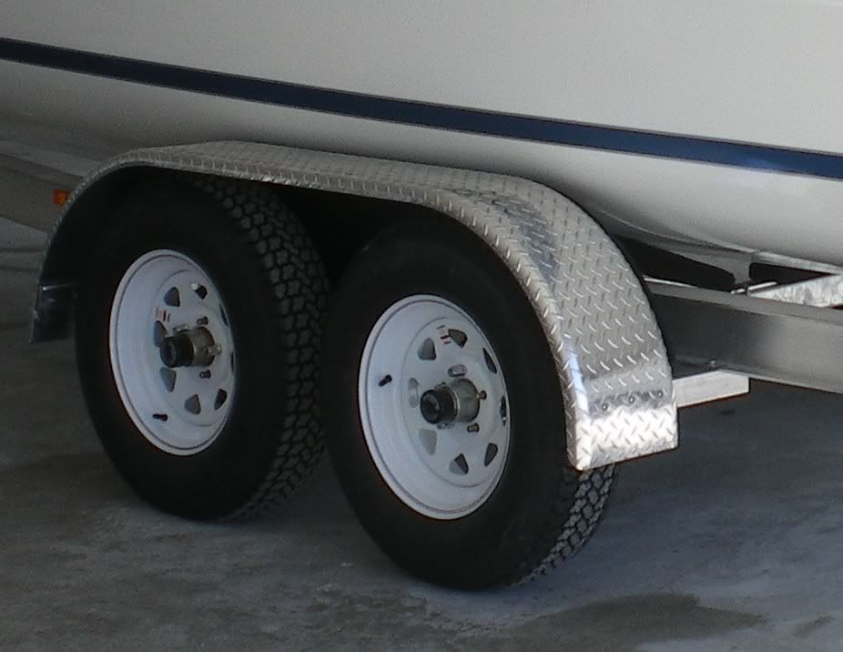

What I did on mine was to add a bunk at the new axle, so essetially I have three aft bunks that the boat sits on and of course the V bunk at the front. I did this because I have slowly been increasing the overall weight of my boat as I add more mods to it. I wanted to have more support under the boat, however with the three bunks in relatively close proximity you need to be sure that they are all properly built such that one is not higher or lower otherwise you will not be distributing the load.RussMT wrote:
Did you have to move the trailer bunks and/or add a new one to the new axle?
What did you do for the fender?
As far as the fenders goes, I built new metal fenders - There are a few companies out there where you can buy pre-formed diamond plate aluminum. I built the inner fender wells from plywood, and covered them with bunk carpet for a very professional look then made alluminum brackets to mount them securly in the correct loction.
There is VERY LITTLE extra room between the tires, fenders, and the boat with this design. So I would recomend you have all the parts in hand and you have a good plan of atack before you start this trailer mod. I've been trailering this mod for a few seasons now with no issues at all. My tires don't rub, and the boat has never bumped the fenders.
