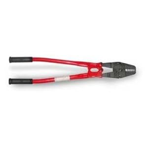

Handy type people....I'm redoing standing rigging on my harpoon fleet and have finally realized I need a swage tool at home
Any recommendations for a source?
Harbor freight doesn't seem to have a cheapie...... :cry:
Right now it looks like about a 90 USD outlay ...a bit too much to not justifying driving to WM and using theirs....

I think that BWY has an inexpensive one.

Get one of these....
... you will like it, especially if you are doing more than 1 or 2 crimps. I looked at the other one and it just looked too slow and a pain to use. Don't forget you have to crimp each swage 3 times.
Here is a link on Amazon to one like we bought.....
http://www.amazon.com/Tie-Down-43005-Ha ... B000CSNJAI
We searched around and found a place that at the time had them for about $55 if I remember right, but I haven't seen them that cheap since. They will I believe also crimp more sizes than the other one 1/16 to 3/16. I used the 5/32 for what I did, but on a Mac if you wanted to stay with the stock forestay and shroud sizes you would use the 1/8 and 5/32 and it will do both of those. I might get some 1/16 swage ferrules and make up some 1/16 wire as tethers for things I don't want to drop overboard like the pins for the anchor bow rollers.
The nice thing is that when you do the crimp you just pull the handles all the way together and they go over-center and create the crimp. Perfect every time and you are done in no time. You get a go-no-go gauge with it to check, but I never had to redo one. We carry in on the boat with wire and swages just in case we ever need it on a trip.

I have used the BWY swage tool when I put on my stern seats. It did seem to work well but like Sumner said it is time consuming. I believe I am going to spring for the tool that Sum used so that I can change my rigging. I will keep the BWY tool on boat for emergency repairs. As I do not have all those cabinets and storage places made for my boat yet.

I have one similar to the pic posted by Hamin'X. (very slow, but works well). I've had it for years.
A friend of mine told mine that Lowe's has one (the one that looks like bolt cutters) for thirty, or so, bucks :!: He got one and says it's great. Haven't been down to look at one myself, but plan to.

Steve K wrote:A friend of mine told mine that Lowe's has one (the one that looks like bolt cutters) for thirty, or so, bucks :!: He got one and says it's great. Haven't been down to look at one myself, but plan to.
That's the one I bought a few years ago, at Lowes. It has dies for 1/16, 3/32, 1/8, and 3/16" wire. It was relatively cheap (I think I paid less then $30), but works great.
It won't do the 5/32" wire rope used for :macx: shrouds (so I bought them from BWY), but I've made my own 1/8" backstay, and numerous lanyards and tethers for various quickpins and such out of 1/16". That's in addition to stuff around the house, of course, as well as our local high school's robotics team, which has discovered the joys of light-weight tension members.
