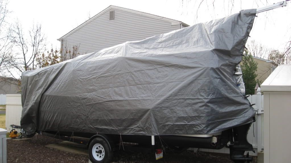

I got a standard cover from a hardware store. I forget what size but it covers the entire boat. They come in different colors.
Using this system worked well. PVC pipe as an arch simply bent and tied down.

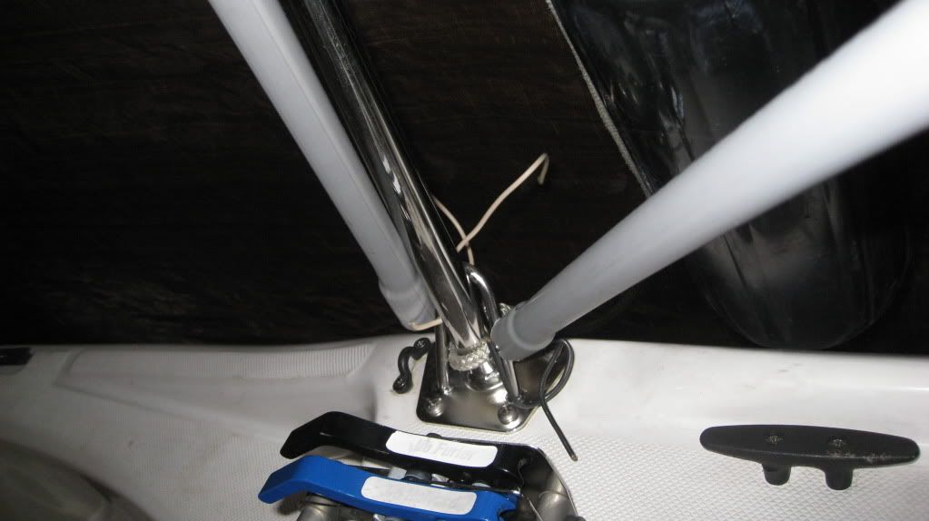

PVC size? They are 1/2 " x 10' standard lengths from the hardware store (Home Depot) and very inexpensive.
I took wire ties to attach them to the stanchions or just pinched them between the deck and cover. The pressure seems to keep them in place. (Double click the image for more detail) We get some nasty winds and the system holds up pretty well.
I then laced the cover using the grommets like a pair of sneakers under the trailer with a long cord.
Any place the cover touches rigging should have some extra padding placed to protect it.

Yea, the stanchions are easy. You could tape them or some such thing, but then the goo gets on them. Wire ties work well.

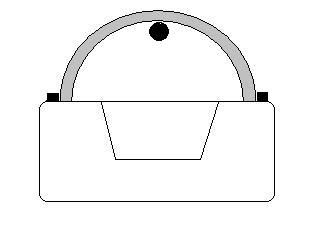

The deck:
It's hard to explain. I have an M and I assume the X is the same. The upper deck has "rails" or channels along the top of the cabin. Bending the tubs causes sideways pressure for them to bend back out straight. The weight of the cover pushes down on them and I bend the pipe so that they are pinched inside these "rails". Even if they come out, the mast holds them up and they will still arch.
I'm at terrible artist, but this is not a purse. The gray arch is the PVC that is pinched behind the black "rails".

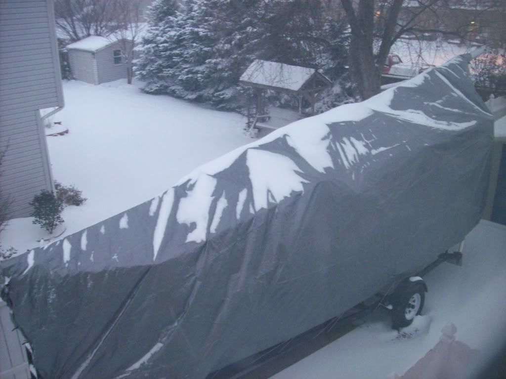

Also, how does this hold up to the weight of snow?
And ICE.
This setup has had a lot of snow and ice on it. It holds up well. Most of it runs off, but there are pockets that pool and it holds the weight. I do add a piece of 2x4 at the mast step to support the horizontal mast.

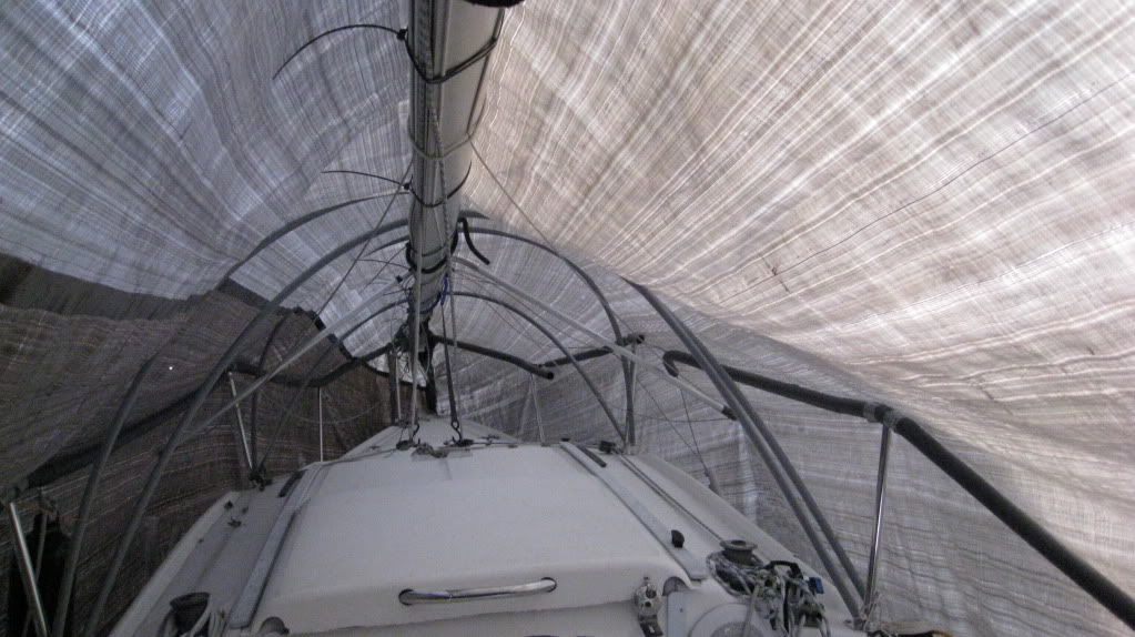

Let's try some more pictures.
Double click to enlarge
