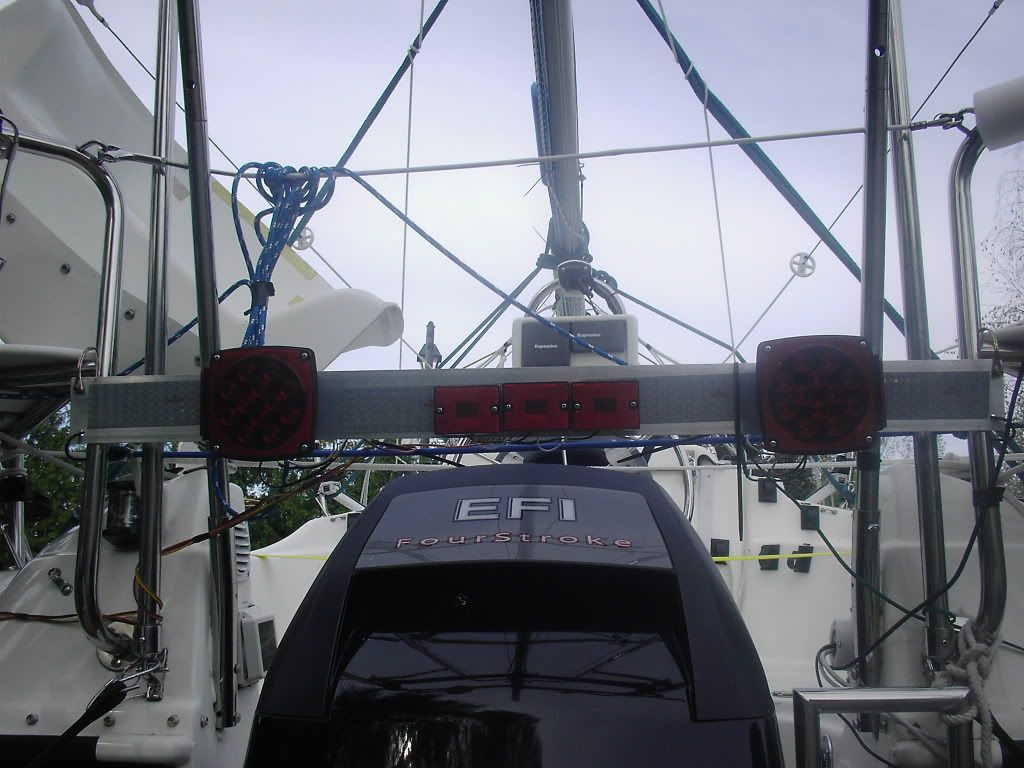

- Posts: 5995
Re: Trailer Light Kit -- Looking for Recommendations
Here's what I done to my trl I bought L.E.D. lights & done this mod for two reason's #1 seems alot of people like the L.E.D. lights but not the price of them ! so when installed on the trl pernamemtly they are two easy & temping to steal , had one stolen already at a Marina !!!
Anyway I noticed that when in traffic bumper to bumper or very slow moving traffic the vehicle's behind you tend to get very close to the back of the boat once they get up to about 8ft from you , your tail & brake lights disapear under the boat so if you start moving & then start braking again & their not paying attention I have had a few close calls even though I have this big orange flag flying off the back of the motor !!
So I made up an light bar from 3" X 1/8" x 41" long alum flat bar & install the led lights on them then solder pig tails onto the rear tail & cluster lights , then solder pig tails onto the light bar lights I can now install these on the very rear of the boat in two mins & remove and stow in the trk outa sight from anyone who had evil idea's
http://s844.photobucket.com/albums/ab1/ ... 010026.mp4
Here's the light bar mounted with 1/4" hitch pins on top with a bungy cord on the bottom to keep it tight & from flopping around going down the road
http://i844.photobucket.com/albums/ab1/ ... 010021.jpg
http://i844.photobucket.com/albums/ab1/ ... 010020.jpg
Here's the lights flashing see the diff between the reg & led lights on top
http://s844.photobucket.com/albums/ab1/ ... 010019.mp4
Here's the lights on , notice how the bottom lights disappear when I walk up close to the back of the boat
http://s844.photobucket.com/albums/ab1/ ... 010018.mp4
Here's what the reflective tape looks like when your headlights hit them
http://i844.photobucket.com/albums/ab1/ ... 010016.jpg
If you like I can post a pic of the light bar off the trl later on
