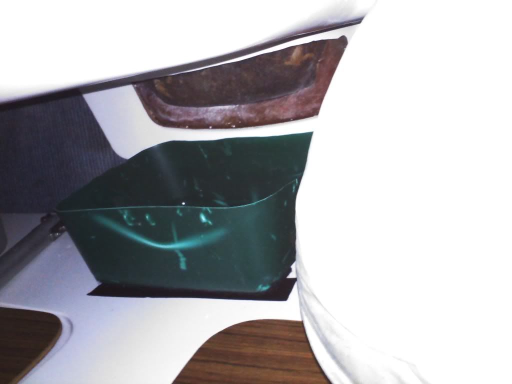

Howdy Vulcan I see you share my pain. Living in an humid state you being in South Carolina and me being in Virginia. You also have a 26X with water in the rear berth after it rains well surprise, surprise me too. I will tell you if your boat hasn't had every single screw, bolt, or any other equipment that passes through the deck/ceiling resealed in the past 10 years you need to start there. The dip in the ceiling in the rear is mostly just inner hull, there is quite a bit of space between it and the outer hull. I bring this up because mine was cracked when I got the boat and was leaking water so I just cut it away with a cutting wheel. I then placed pictured square bucket under it. I found that it would be almost completely full after a hard rain until I resealed all of the above mentioned hardware while making access ports to get to said hardware I noticed something else. Humidity even on a hot day collects in the ceiling space between the hulls up there. So my solution was to run two dehumidifiers at the slip (or in the driveway when my boat is home), and place two of those humid absorbing bucket dehumidifiers up there, one for each side along with three others scattered in hidden places within the boat. Now between emptying or at least checking those absorbing bucket once a month, and resealing everything except my rub rail (which I need a new one), and using the dehumidifiers I only get about a cup or two of water in the square bucket Velcro down after a hard rain. I think when and if I ever replace the rub rail I won't even have that much. Now if you decide to do what I did (removing all insulation then reinstalling it after resealing everything and making 6 access ports in that ceiling) I hope you don't have small children around to hear you talk to God in a most stern manner.
