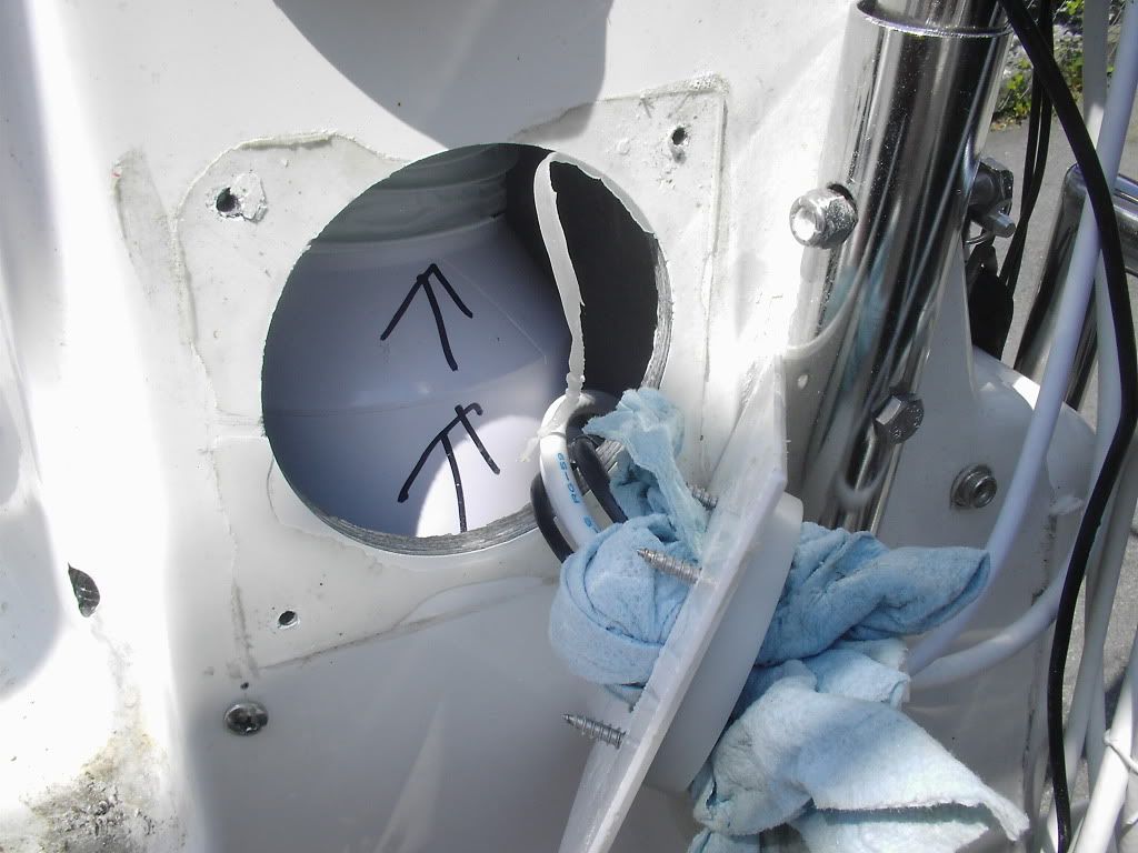

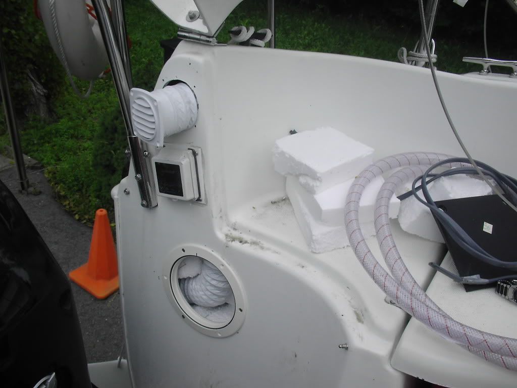

- Posts: 5995
Re: Inboard 26X fuel tank
You may also want to consider installing a bilge blower !
http://i844.photobucket.com/albums/ab1/ ... 010007.jpg
http://i844.photobucket.com/albums/ab1/ ... 010053.jpg
Highlander, My concern with your desigin is the exit of explosive fumes so near
your shore power plug.
- Posts: 5995
waterbear
Thats the fresh air intake on the port side beside the hydro inlet ! , the outlet is on the same location on the S/B side the blower motor extracts the air from either the head or bilge at the V-berth fresh air is vent in at the aft berth their fore exchanging all the air in all the bilge areas through out the boat is a hundred times more efficient in exchanging air in the bilges at any given time and is instantly exchanging air ,passive venting is good for for slowly exchanging air for moisture & fumes and or when the boat is unatended , I have a small passive vent not yet installed have not decided where to mount it yet which can be left open in bad weather as it does not allow water to enter although I would close it in severe conditions while underway
to each his own !
but I would never ever consider installing an inboard gas or fuel tank without a sniffer & blower also it would be self enclosed in its own vented enclosure with some sort of manual drainage system !
I do believe Kevins tank is self contained & vented , although I have seen some on this site who just installed a fuel tank strapped into the aft berth area ! even though its vented to the outside leaks can and do happen !
would you take 60l. of gas to bed with you in the house ??
