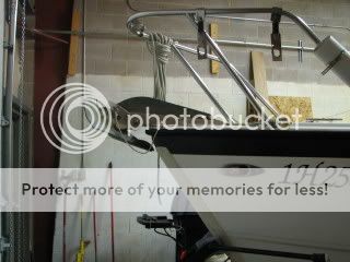

This works pretty darn well for me.
Big honkin' CQR (don't know - 20 pounds?), 30' of 1/2" chain and 200' of rode.
We use all of it, all the time, unless just stopping for lunch.
Secondary Danforth ready when needed, hangs from the brackets you see in the pic.
We generally back down on this thing as hard as we can until the boat simply stops moving.
We've swung over 180 deg around one of these and , yes we moved a bit, but it digs right
back in. We had it buried pretty deep to start with. Some mornings it's tough to retrieve,
but patience coupled with a good night's sleep have always brought it back up.
You could think about installing a bow roller to open up your options.

I definitely second the motion on adding a bow anchor roller to the X. It allows for convenient mounting of several different styles of anchors, as in the photo above, that wouldn't otherwise fit in the locker. This frees up space in the locker for a rode with generous length of chain. I keep two fully rigged nylon/chain rodes in the locker, with primary bruce anchor on the roller and the secondary fortress on a bow pulpit bracket. This works very well for us.
