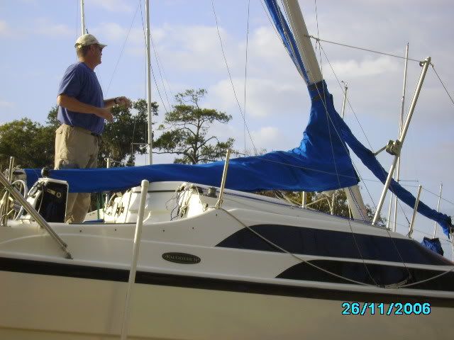

Erik,
You can lower the mast with the boom and main still attached. At least on my '05
I can do it. The gooseneck swivels just fine. However, with the halyards let aft I was not able to slide the mast all the way forward so I trailered with the mast tied down secure but about 5 feet short of all the way forward...one long trip and then only short trips after that...and of course the mast stuck out the rear 5' further than normal.
Allow the boom to rotate off to one side as the mast comes down...I alway let it rotate to port...and when complete the mast will be rotated some...but completely do-able.
Coming down...rotating to port side by physically pushing the boom to port.
Once the mast base is disconnected I can slide this forward about 1/2 way to the pulpit...tied down securely.
Sticks out the back...but you may be able to get the mast all the way forward if you take off the halyard.

Thanks Jim and those are some great pics. I have a few questions just to clarify.
You have a furled Genoa, right?
Do you keep the main slugs inside the mast? I imagine so, since the cover wraps around the mast. If so, can you see any signs of wear? It's so nice to know I can leave the boom on the mast all summer and in the garage all winter. And the cabin belongs to the Admiral all year 'hiccup' long
thanks again,
Erik

Yes on the furled Genoa. Yes on slugs on the main and kept inside the track on the mast all the time...never came out when I did this.
No signs of unusual wear that I can see.
However, I no longer leave the boom on the mast when trailering or storing the boat. I take the slugs out of the track and then roll the main around the boom and store the boom (with the main still attached and rolled around it) inside the cabin. I remove all lines (halyard, main sheet, boom vang, reefing line) and store the mast in the normal/recommended spot. I do this due to my "long term" outside storage.
However, it can be done.
The one problem I have experienced is that I do have a few shallow "bends" in my furler from where it was strapped to the mast during storage. I am pretty sure they will work their way out when I have the mast up and in the heat of Florida...someday...when I get back to Florida. I guess I could take the Genoa off the furler and that would probably help me store the furler a little "straighter" but that seems like more effort than necessary...I am essentially pretty lazy.
