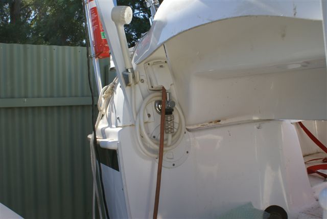

If you want to use through bolts you will basically have to do what the factory does with the Aust boats when they install the stern rails which incidently are a great handle for hauling yourself up the back especially if you use the motor to sit on.
These access ports are essential for adding extras like arch supports power and water inlets etc.
