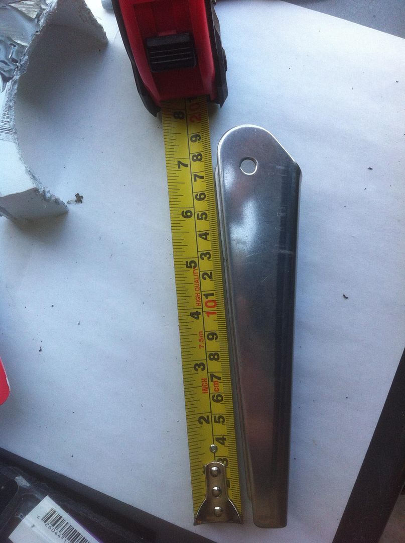

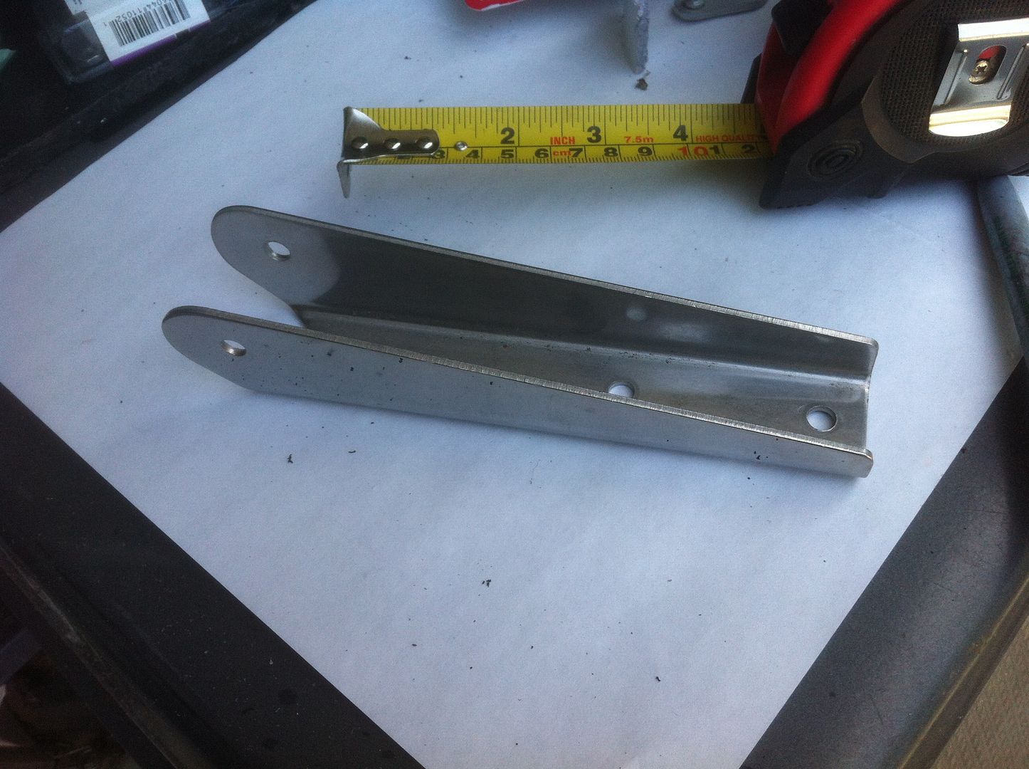

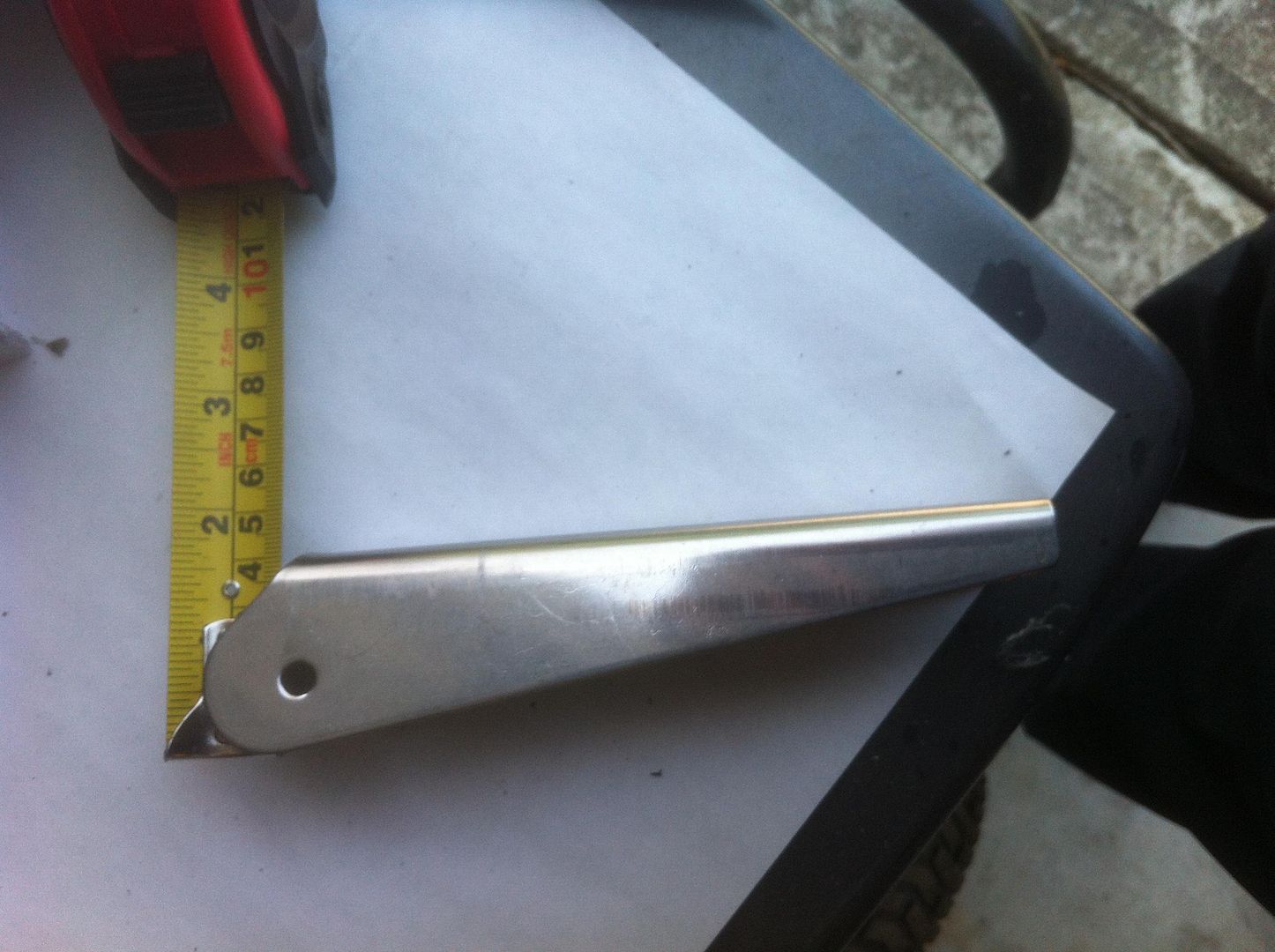

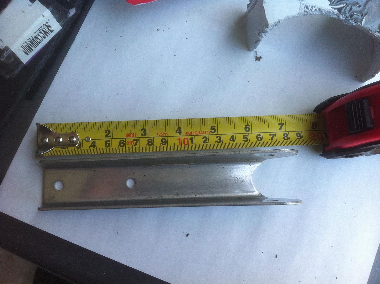

Oh Yes they do if u stop my vid @ the 32sec frame u can see one under my stern rail seat ! I can try to take a pic of the ones laying in my shop if I have time tomorrow with the measurements they do not have the tang on them but that could be very easy to do seach for a tang already made with the option of adding it by either welding it or bolting it on :idea: :)

here u r these brkt's r about the same size u r looking for they fit over that 1 1/4" tube up-right in my pics that is part of my rear arch traveler back-stay set-up
http://i235.photobucket.com/albums/ee20 ... 0008-1.jpg
http://i235.photobucket.com/albums/ee20 ... 010004.jpg
http://i235.photobucket.com/albums/ee20 ... 010001.jpg
I took these when I was making that arch it was still in the early development stage @ that time, I have or should have two more sets of these brkts left to be used on a future mod "retractable swim platforms"
will give u the measurements tomorrow when I get home
If u want to get as many mods done as I do on the cheap as I do , u have to be prepared to do a lot of seaching on the net & the marine flea markets which does use up a lot of time & be willing to wait for stuff to go on sale & be willing if u r able to make alot of the stuff urself , hope this helps u out

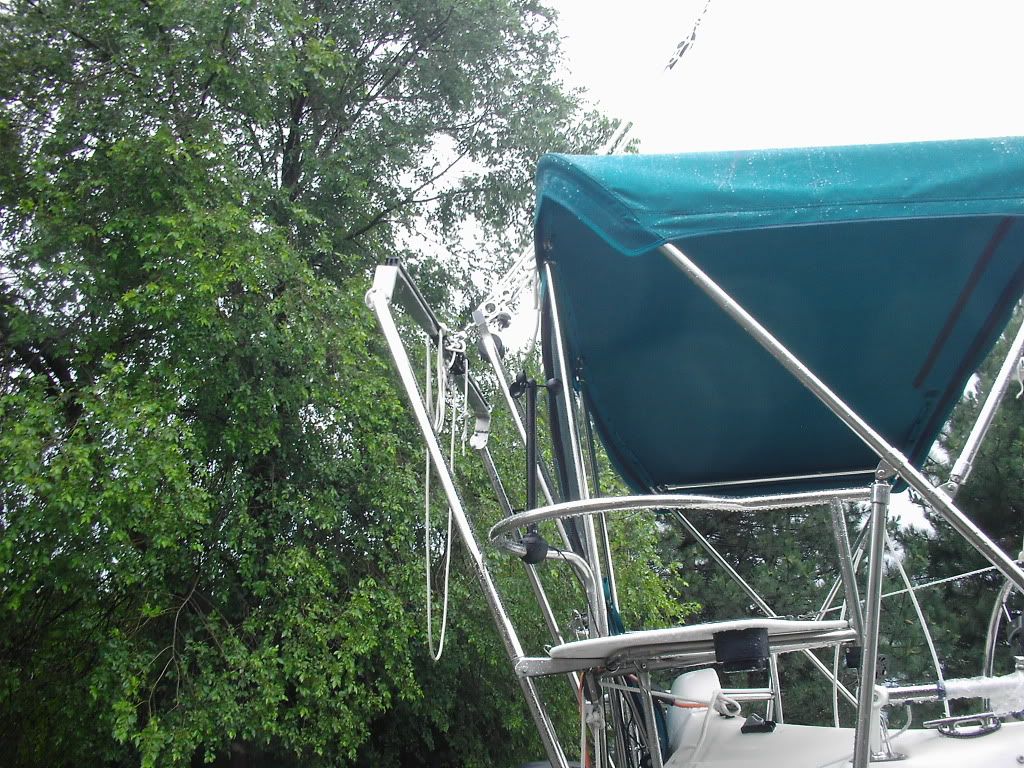

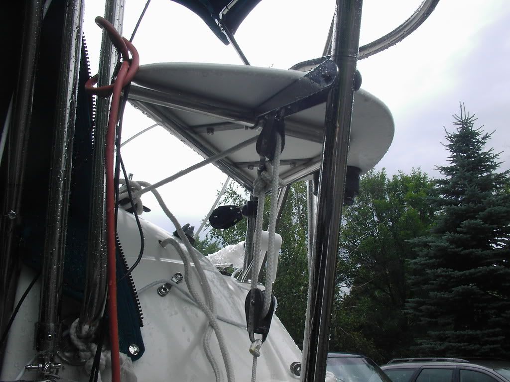

PS u can also see my 3-1 rudder pull-up conversion which works great on my large heavy solid IDA Sailor rudders

Oh I see. You're using those brackets for a different purpose, but I could use them for my purpose. Yeah, that might work.
But even more interesting, you're using blocks attached to the underside of your party seats. That is a VERY intriguing mod. When I'm down at the boat tomorrow, I'll check that out. That might work for me.
