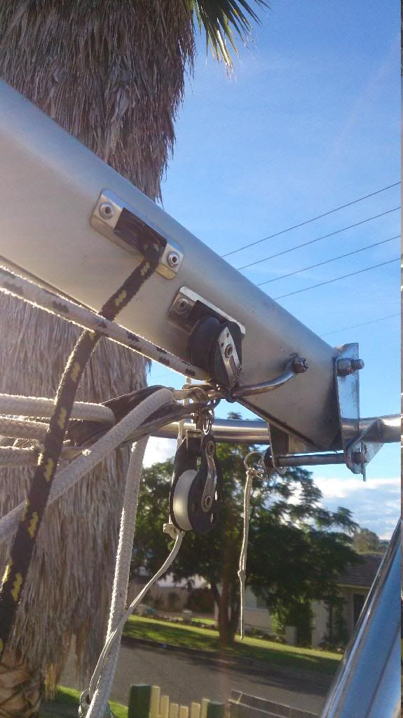

The first photo shows internal halyards entering the mast. There should be some turning blocks on the deck to bring the lines back to the cockpit.

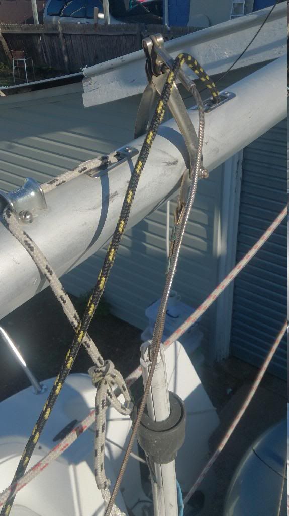

The second photo shows the chicken head and backstay, which should terminate at the starboard side of the engine well.
Regarding the furler, it actually does look usual, just not usual for an :macx: . The white internal halyard hauls up the top bearing of the roller furler, with the sail in tow with it's luff in the slot. That's pretty standard, but definitely not like the unit supplied with Macs as an option. The halyard is guided below the forstay to hold some angle to the bearing - if it wasn't, the bearing might spin and wind up a bit. Also pretty typical. The black halyard is for the spinnaker, as far as I can tell. Hopefully you got an asymmetrical spinnaker to go with it.
The whole thing would be easier to visualize with the mast up, IMO.

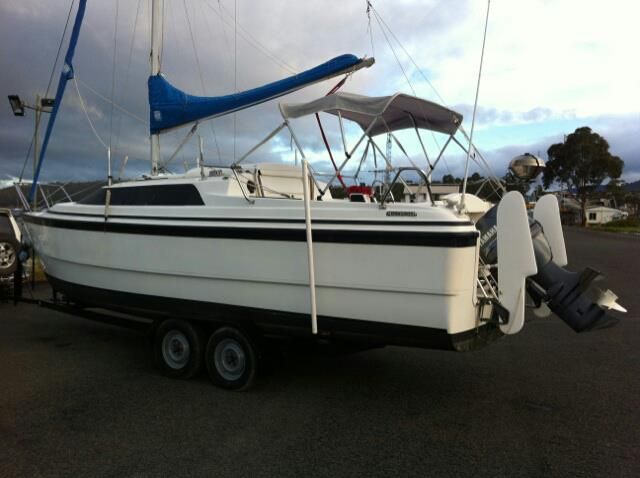

That's a nice mast. But nothing like I've ever seen on a Mac X.
I would presume someone replaced the mast with something from another boat.
Also agree, that mast up would be easier to see.
The backstay cannot be combined with the outhaul on any rig I've ever seen. Scary thought about running downwind without a backstay.
In this photo, what is that cable attached to? Appears to be a backstay.

Cheers Tom, the first photo is actually the foot of the mast showing where the lines come out (and then they go into the block, into the organiser and to the cockpit :) )
The second photo is the backstay but the backstay stops at about boom height, so I figured the outhaul (I think thats it) attaches to it to keep the boom up (sorta like topping lift)...I was advised by previous owner that in the same connection, two backstay lines/wires are then connected to port and starboard aft (as opposed to one as per original design)...it seems I'm missing the two backstay wires so will need to remedy this

I've received a picture of the mast up and rear config from previous owner so here it is

Hi Russ, so yes that's the wire in question...its a backstay but its length only runs to just above boom...previous owner sent me a pic and shows that this wire is then connected to twin wires hooked to back of boat...but the outhaul is also connected to it...maybe i'm using wrong terminology but what I call the outhaul is the line that pulls the sail on the boom away from mast....and that line (which is very thin by the way) is hooked up to the backstay....
