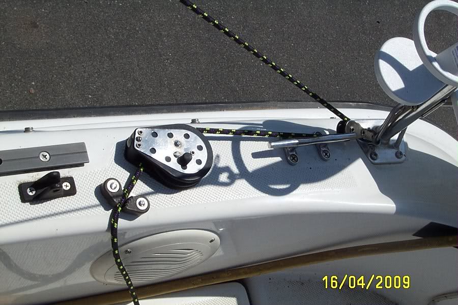

Our setup in the cockpit looks like this http://i293.photobucket.com/albums/mm42 ... cleatf.jpg This is some hardwear that was on my wifes old boat but it still work great for our gennaker. It's an adjustiable ratchet block and cam cleat, it's really easy to use. We have added the extra mast hound 20 inches up the mast and a long anchor roller to mount an adjustiable tack line. http://i293.photobucket.com/albums/mm42 ... nakert.jpg With the adjustiable tack line controled from the cockpit (where in the photo you see a rubber tiped fairlead for the gennaker sheet and the yellow line in the adjustiable tack line for the gennaler and the roller furrling line) http://i293.photobucket.com/albums/mm42 ... pinnak.jpg the person flying it does not have to get out of the bhttp://i293.photobucket.com/albums/mm42/bubba26M/Newlongeranchorrollerwithspinnakert.jpgow hatch to launch the spinnaker or bring it down. The advantage of a Choot Scoop spinnaker sock is very important. Feeling comfortable and making it easy to fly a spinnaker/gennaker is very important in having fun sailing.
