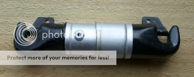

Maybe what I really need is a longer whisker-pole ...delevi wrote:My spinnaker pole is a heavy duty whisker pole $335 Forespar which for our rigs is sufficient. I wouldn't recommend the $150 pole with plastic fittings.

Either that or some of that vgra-xd stuff. I really tryed to spell it correct.Rick Westlake wrote:Maybe what I really need is a longer whisker-pole ...

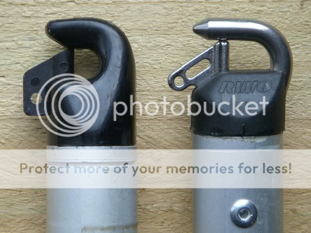

Yeah, not much of a "rise" out of that whisker pole, eh?
Actually, I cut those Forespar tips off my $150 pole (PO equipment) and replaced them with RWO tips.
The cut-off Forespar ends were just too good a photo-op for this thread, though.

Rick,
The fitting looks good but the 1" pole may not be up to the task. I guess if you're willing to risk breaking it, no harm in trying. In light air, it may be ok. The length should be 10.5' (size of the fore triangle.)
