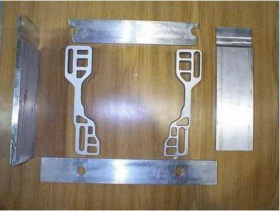

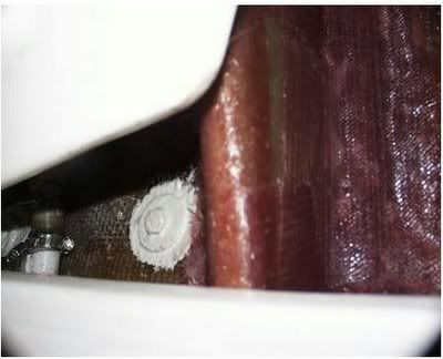

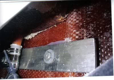

Re: Suzuki DF70 - Installation & Transom
Just captured some archive-pix that were linked to older threads - just to save them for posterity. These pix of the 26X transoms were either from Mark's Suzuki 115 or Billy's DF140. Whether you want or need to reinforce an M's transom for just the Suzi-70 ... your call. As I posted earlier, my DF60 was one of the first oversized motors (bigger than 50).Derrick wrote:When installing the DF70 is any transom reenforcement required or recommended? From what I have read through various postings it seems the M boat will support the DF70 fine without any extra support. I read some postings that recommend a aluminum support, but I have also read where this may also cause problems.
Mine probably WAS the first oversized installation by a Mac dealer, earlier installs by individual owners. Gene Arena insisted on reinforcing my transom - probably overkill - and he didn't use a little flat AU. As described above, he installed a beefy AU channel - had to drill it to clear the transom drain (I lost those photos in a disk crash). Gene also extended the inner channel another six inches (each side) beyond the inner bulkheads, so it could also mount the bolts for rudder brackets.
On the 26M? ... YMMV.
Inner Transom Bulkhead
Billy's Aluminum Parts Bin
Billy's Transom Shot
Mark's Transom Shot
Mark's Motor Well Plate (Bad point-loading caused cracks)
Revised Motor Well Bar (relieved of point-loads)
Edit: Oops - that HS chem class was in 1964 ... here's the more recent
AL =13 and AU =79, which is OBVIOUSLY too heavy for a Mac transom - please alter your mods~!

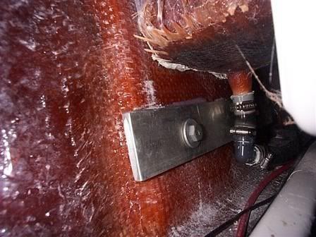

me...i had an '02 Suzi 50 and upgraded to a 90 tldi.Dimitri-2000X-Tampa wrote:If I was going to the trouble of reinforcing the transom, I would also want at least a 90HP. Do we have anyone on the board yet who has gone from a 4stroke 50/60/70 to a 2 stroke etec or tldi 90?
here's my transom reinforcement, plus (not shown) the bar accessed via the rear berth as seen in photos above.
BTW, for the 90 i was able to use the same thru holes as the 50 so no additional drilling needed.
