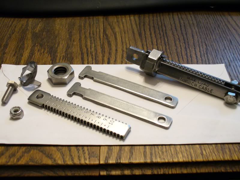

I've done a lot of measuring on my 26X, but can't say how that might relate to your M. For mine though ... yes, my first stab at mast rake was by using the trailer's tongue jack to level the bootstripe, with that 24" digital level Moe mentioned. It reads to the tenth of a degree, showing from 90.0 to 00.0 degrees.
Coincidence! ... just noticed that Sears shows a similar device in one of this year's Christmas TV commercials. They're showing just a 12" model but you can also get a longer model (probably about $75)..
Before starting I had moved the trailer to an open section of our mast-up parking lot. My assigned stall is not level side-to-side, so I found a vacant area that would nearly level the axle, then unhitched the trailer ... etc. After leveling the bootstripe I checked level on deck, finding that the leveled bootstripe also left the sliding hatch level too - happy circumstance!
Now it was a simple matter to check plumb of the mast - my 26X was 86 degrees as delivered by the factory. You might reduce that by about one degree using just the turnbuckle (fully collapsing it), but my forestay was kinked so I needed to replace it anyhow. I took the old one to the rigging shop, asked them to make me one shorter by 4 inches. That change reduced my rake from the factory's 4 degrees aft ... to a new rake of exactly 2.0 degrees aft. I feel that 1.5 to 2.0 degrees aft is the best setting for a 26X in heavy winds. My change of 4 inches delivered 2 degrees, doing again I'd choose 5 inches shorter.
Be aware when shortening the forestay, you must verify that the new forestay will be long enough for your jib's luff length. My factory forestay had 9+ inches of excess stay length.
Regarding the process, I followed about the same procedure as Moe describes. Since the rig is already at some state of tune, just raise the mast and note the current shroud tensions in your log. I have the Loos Pro gauge pictured below.
Now you can sight the mast to be sure it is straight, then add upper tension to a target of 350 lbs. Leave the raising gear in place to release the forestay, shorten adjusters for both upper shrouds, reattach forestay, recheck tension. (If the starting tensions differ widely on port and starboard, I'd recommend adjusting only one shroud, target making them equal for starters.) Record all four readings each cycle since the tension on lowers can be altered by changes made to the uppers. My final settings are about 365# for the uppers and 325# on the lowers.
Finally, pictured below is a recent change where I added Sta-Masters to my rigging (total cost ~ $120). I feel they are a vastly better solution than even turnbuckles. They are very beefy stainless, indexed, make it MUCH easier to gauge your tension alterations - the picture speaks for itself. Read about it in this earlier thread, titled Mast Rake.
Note: Sta-Master was patented by a bright guy somewhere in the mid-west. I've spoken with him on the phone, but I have zero affiliation with him or his product, just appreciate the ingenuity. They are very popular among the racing dinghy classes and he advertises them in Sailing mag - where I came across them. I thought they'd be a great product for Heath's catalog, but my poll of our membership showed very little interest, so I just dropped it. Still - highly recommended for anyone serious about tuning the Mac's rig.
