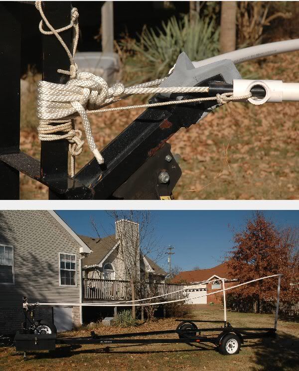

PVC Pipes, nylon ropes inside to reinforce, all removable in short time, but I leave it on all the time. Catches the boat if it is not straight when driven on. Note the side boards on the fenders. Pressure treated 2x6, covered with in-out carpet, and bolted at the fender and goal-post. protects the hull from contact with fenders.
Nice pix ALX...that is a neat arrangement - it would be useful for me when I extend the season here up North, and sail in November, and the docks come off the ramps. Its tough walking the boat onto the trailer without docks, but your arrangement makes that a lot easier.

In review of all the pictures, I have these questions or comments for anyone to help me with:
1. In one of the last shots I see the trailer with carpet covered wood supports perpendicular to the boat in two places, lateral, in other words. My trailer has two parallel or longitudinal, wood supports. They extend from the stern to the ice chest area on my X. There appears to be a slight 'sag' in the hull just forward of the end of the support. Should the supports be longer? Or should I scrap this method and go with cross-wise supports as shown in the pictures?

Opie,
The factory X trailer only has 3 supports, all crosswise (side to side). You can see them clearly in the pictures with the PVC pipe. One is at the extreme back end of the trailer, the second crosses just nehind the aft end of the centerboard trunk (esentially under the cooler), and the third is the small vee shaped set at the bow. The boards on the fender tops in the picture are not factory. If you have fore /aft supports (the norm on most trailers) then your mac trailer has been modified. This is not the way it came from the factory. I would worry if I was getting a indent at the end of the bunk. The weight of the boat is not being distributed correctly. With the side to side bunks I've never seen indents in the hull.

Duane, now I am concerned. Yes, the previous owner told me the original trailer died with acute rust-e-osis. The Load-Right trailer was made to order. With longitudinal boards for support, I will take a straight edge and other measurements to see if I have a forward sag just forward of the boards. I think this is serious. Does anyone else have boards like mine? Any concerns or damage done?
..... x x x x x x x x x x x x x
...x.................bbbbbbbbbb
x.....................................the "b's" indicate my two support boards.

opie wrote:1. My trailer has two parallel or longitudinal, wood supports. They extend from the stern to the ice chest area on my X. There appears to be a slight 'sag' in the hull just forward of the end of the support. Should the supports be longer? Or should I scrap this method and go with cross-wise supports as shown in the pictures?
4. It appears the rudders are in a 45 dgree position when trailered. Shold not they be straight up with the pins in place?
IIRC, Dimitri's boat lift uses long stringers under his 26X, so maybe he'll offer an opinion.
Meanwhile, seems to me that Roger's design has lots of inate lengthwise stiffness. The ballast tunnels are like 4x6 timbers along the bottom, plus the chines provide natural reinforcement for the hull bottom. But there's little beamwise support in the design. Bulkheads are absent from both X and M, except for the cabintop/companionway structure, and of course, the transom. Just a guess, this is partly why Roger's trailer uses beamwise bunks.
Since I've never read of a powersailor suffering from sagging hull, seems to be working. If your 26X hull shows distortion I'd think it best to modify that Load-Rite ... shouldn't cost very much.

I'm a mechanical engineer by trade, and I don't believe it's possible for there to be a sag in the lower part of the hull without a corresponding buckle or actual crack in the upper part of the hull.
Im an eternal optimist, but what you might think is sag might be the illusion of the hull compressing the bunk carpet at the end of the bunk lumber. Since the straight line of the lumber and the hull is visibly broken, you think the hull is bent. See Chip's comment above.
In fact, at the end of the bunk the carpet is compressed, the hull still makes the nice straight line, and all is well.

Most articles and owner's manuals regarding trailers for powerboats warn that the bunks have to extend at least to the aft edge of the transom. If not, the hull can develop a hook in the bottom that will affect performance. There is no mention that it the topsides would have to buckle for it to take place.
I think it is some pretty basic, rigid body mechanics that would say you have to have some buckle or failure somewhere else if the hull sagged.
