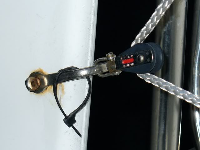

Frank,Frank C wrote:I added a SS "shower bar" (1.5" diam x 24") from HomeDepot. It provides an essential safety assist both on and off the water. I also keep an overturned, 5-gal paint bucket aft of the trailer as a stepping point, and I use the up-tilted outboard drive as a very secure handhold.
Where did you mount the shower bar, and how was it mounted (nuts and washers on the other side of the bulkhead?). Did you have to seal the holes you drilled into the bulkhead?
Jim,
Reach the upper bolts using the factory hole plug at the helm seat hinge. That's pretty easy. The lower bolts required cutting thru the way-back interior liner - it was a bit of a pain, a 2-man job in my case.
I also replaced one of those lower grab-bar bolts with an eyebolt, as terminator for the rudder purchase system ... which still doesn't work very well. I have an upgrade-in-progress on the rudder lifting system.
SS 24" Shower Bar from Home Depot
Rudder purchase: large shackle plus mini-block
