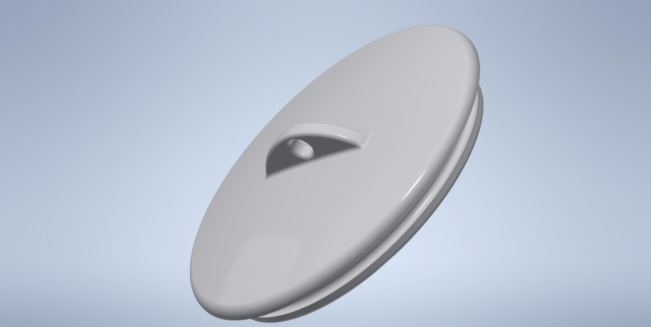

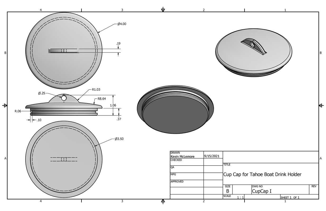

As someone who used to teach CAD, industrial design and 3D printing, I say "Well Done!" Very nicely made. And very nice to have you post it on Thingiverse - I also have things posted there, and I love that folks share their designs.
I haven't made anything for my Mac on my Prusa 3D printer (yet!), but for my Tahoe I made some nifty cup holder covers (to prevent rain water from entering the boat):
I will likely post this to Thingiverse as well.
