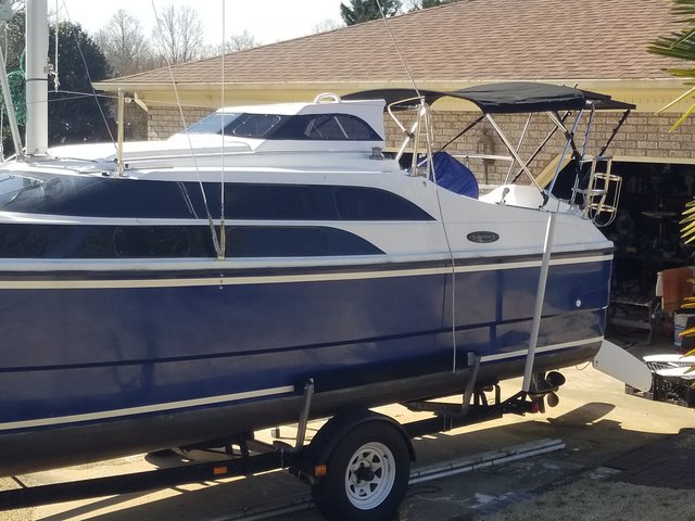

new to this forum, trying to figure out posting photos here, got a link on postimages so will try this. Attempting to post images of my 2005 26M with a removable hard dodger with no mods to the boat other than 4 stainless quick release clamps.

I totally missed that blue P. add image to post. I have lots of photos, even the build. But just a few more details for now. It is made of 3/4 thick Coosa board which is stronger and lighter than ply. Since it is fairly smooth and impervious to water I only glassed the seams where the panels meet and then epoxied the entire shell, window cutouts, paint etc...
It removes in less than a minute, is not very heavy, and clears the boom by several inches. It does have to be removed for lowering the mast of course and best of all for me I made no changes to the boat except for the quick clips that hold it down. It sits on top of the plastic rail and does not interfere with top or door.

Here is a few more of how it looks with sliding top closed and the quick hold downs. I did not like the sage in the Bimini as well. I put solar on my arch and supported the arch with stern seats. Because of the panels location and being adjustable I can place them even to the mast and not remove trailering. Roger
