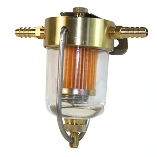

I installed a bigger fuel filter / water separater INSIDE the merc50.
It is one linke this:

Wow, that looks just like the glass bowl water separators that were used on small engines back in the day. Small engines as in lawn mowers (reel) and similar machines. I remember the old Reo mowers used them (Reo Royale and Trim-a-lawn, which used the same engine), as those were my first playthings with engines when I was a kid in elementary school.

Yep I,m pretty sure that,s just a water separator not a filter bad idea with installing inside the out board out of site out of mind ?Tomfoolery wrote:Wow, that looks just like the glass bowl water separators that were used on small engines back in the day. Small engines as in lawn mowers (reel) and similar machines. I remember the old Reo mowers used them (Reo Royale and Trim-a-lawn, which used the same engine), as those were my first playthings with engines when I was a kid in elementary school.

well to be exact:
It is the water separator that has a filter inside that you can change:

Now I see a filter ha hakurz wrote:well to be exact:
