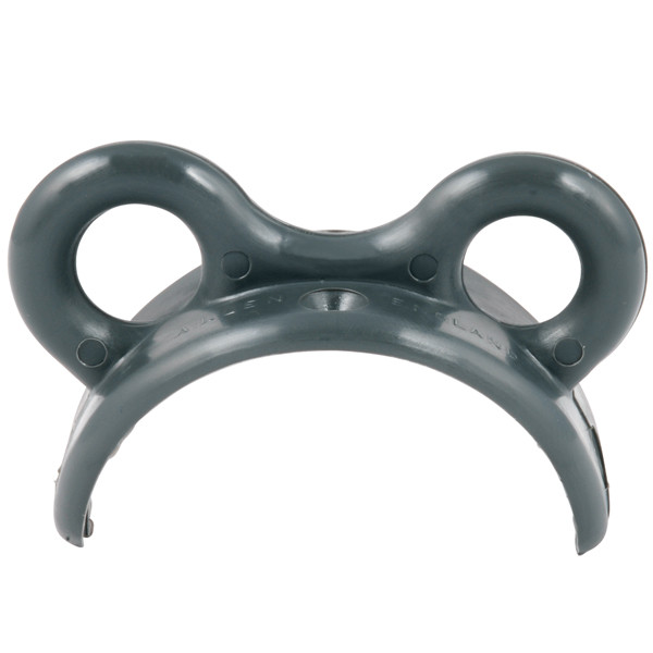

grady wrote:I think they stated you should use the plastic eye because it is sized for the hooks.
Like this one? .... Looks a bit Micky Mouse to me :D
https://www.velasailingsupply.com/allen ... t-bracket/
BTW ... Who is "They"

Thanks Grady,
Yes I spotted that. It looks plastic but it's advertised as aluminium. A local supplier has it as plastic and it has a plastic look about it :D .... So do you think two of these (one either side of the mast) would be up to the job?

I guess you could mount one on each side. It is designed to mount on the front of the mast and work for both sides. You will never need to pull the pole aft to were the front mounted ring will not work.
