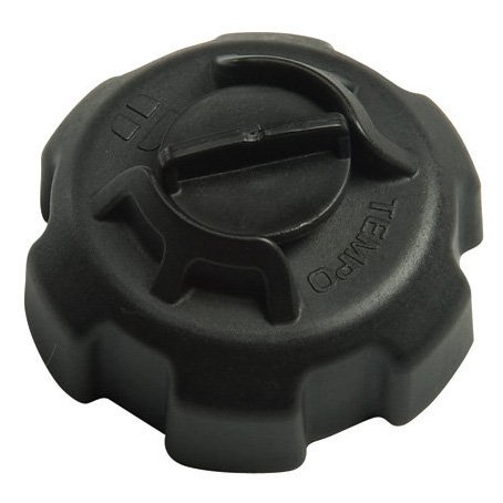

I got the "good karma gas kap" and the Moeller 12 gallon low profile tank fits under mydthiesmeyer wrote:Moeller has a 12 gallon low profile that fits under the 26M seats, if you install a 4" access plate over the filler cap. You may also have to trim off the molding pin inside the access plate and about 1/8" off the filler cap vent for a real good fit. I installed one of these last year and a second this year. Keep your tanks full or vented in hot weather as they do expand and push the seats up.
http://www.amazon.com/Moeller-Externall ... 3KKJ8E41RP
