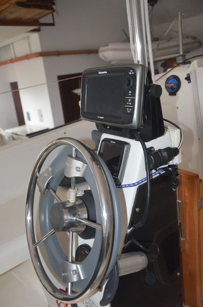

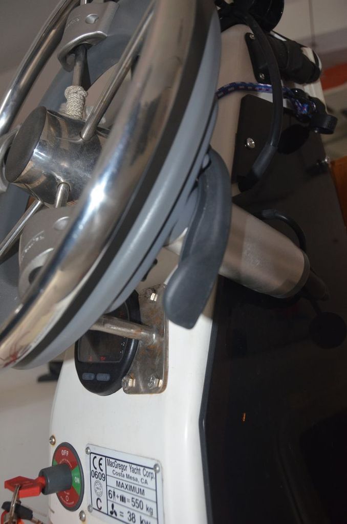

I installed the EV-100 and an e7 MFD:fouz wrote:Those that have them installed oncan your post where you installed it? I have seen 1 or 2 but would like to see what everyone has came up with.
The provided pedestal bracket in the package is for the column type pedestal, so I welded a stainless steel bracket pin:
I installed the ACU-100 on the starboard side above the aft berth (the bulkhead on the left side is the wall of the head):
I installed the sensor head behind the aft wall of the head where you can access the nuts of the starboard winch. I had to make the opening a bit bigger and I made a bigger smoke cover plate. Probably I made it a bit complicated, but the sensor head is definitely protected and not in the way now. You can see it by clicking on any of the above pictures and browsing the pictures in the Photobucket (only 3 pictures allowed in a post).
