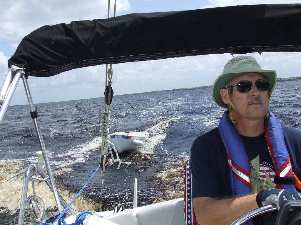

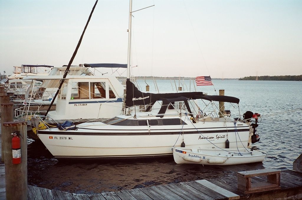

Responding to this aspect of your question, I use a floating polyester rope typically used for water skiing or tubing to tow my dinghy. I use that type of rope because I want a floating line near my engine so I can see where it is at all times. I attach it to the starboard stern cleat for towing so I can get to it even if the rear seat/hatch is up for some reason. You are already familiar, I presume, with the desirability of keeping a dinghy on the downward sloping side of the engine wake so it causes less drag. To do that I have enough line so I can make the needed adjustments as my speed changes. When I anticipate docking, I either bring the dinghy alongside the opposite side to which I am tying up, or I have a crew member board the dinghy and let him or her bring it in on its own after I tie up the Mac.Techniques
- shore ties option. around trees, rocks etc.
- dinghy use
- environmental concerns
- knots
