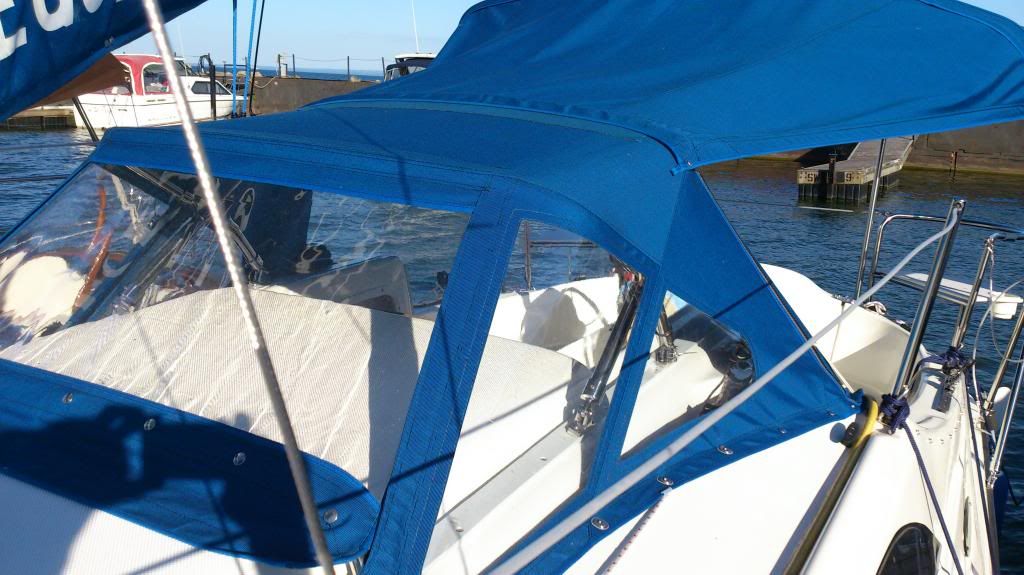

A nice feature that you might want to incorporate (there are many) from the Dowsar M dodger is a bar that staddles the sliding hatch at the front under the windshield. There are dome fasteners along it that don't need to be touched to open and close the hatch. A flap below it that rides on the top of the hatch maintains weather tightness in any position. I took that feature for granted until I read this (Tom's) thread.
You can see part of it in the bottom left of this pic.
