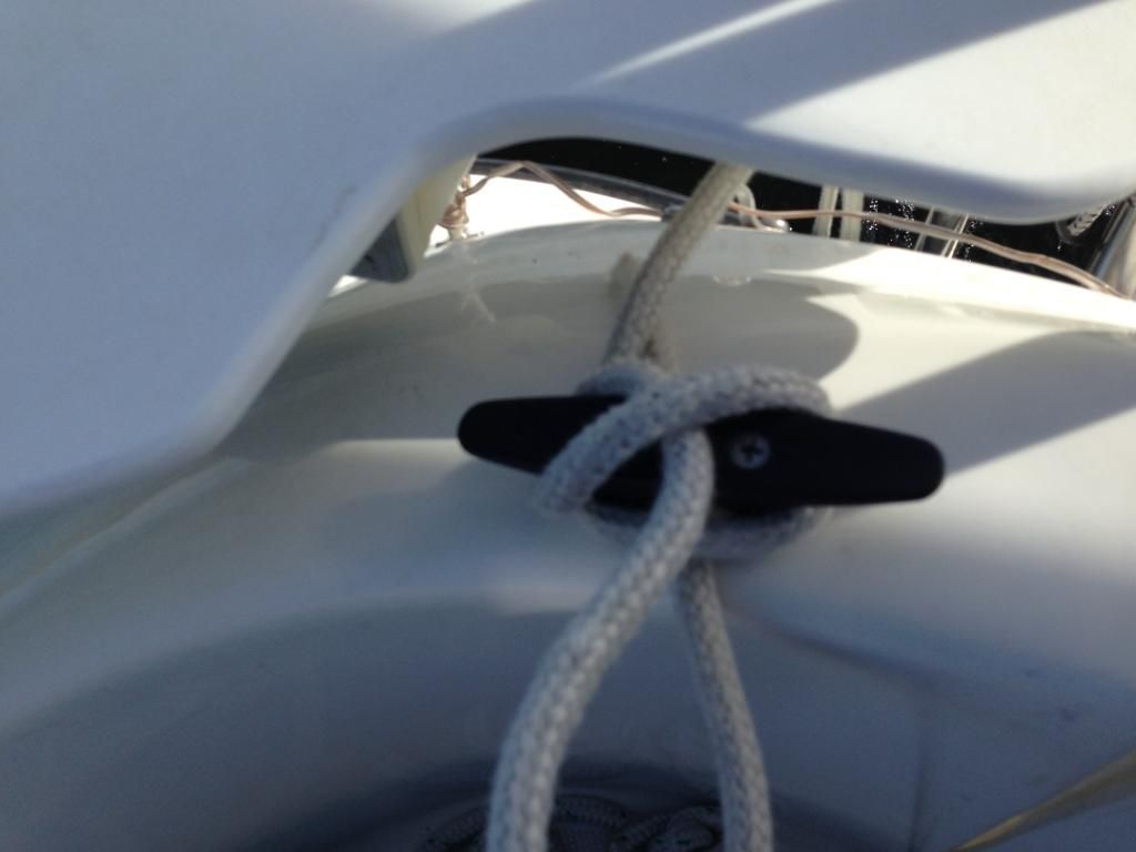

All you need to do is "cleat" the rudders properly when deployed.
Kind of hard to see from this photo.
Pull the board down and hold the line tight. Now with your other hand, take the slack end of the dagger line and wrap the cleat and put twist to secure it. You will have a bit of slack loop left over. The first wrap will apply tension preventing the board line from loosening and kicking up. However, if you pull hard (like the rudder hitting something) it will pull free.
Tada, and you spent nothing and have a safety for your rudders.
