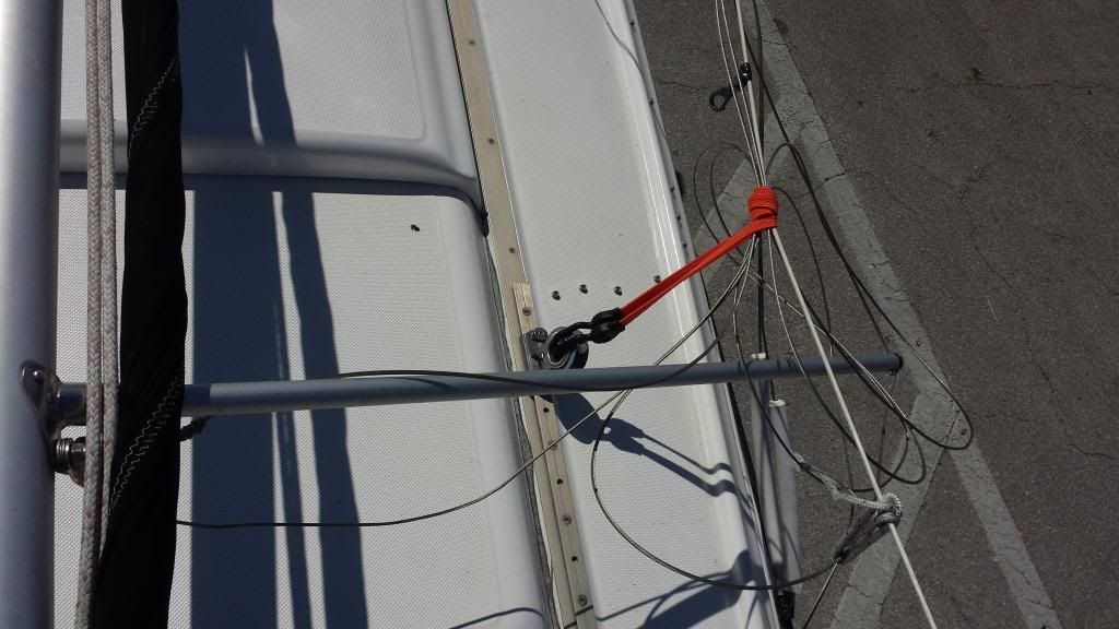

This photo shows the two spots at the sides of the cabin top hatch that I'm talking about--they're the two half-circles where the hatch slides over the cabin. What I do is toss the spreaders and sheets into the cabin, and then pull the hatch back to the companionway. I then "manage" the stays and sheets through those two holes while I pull the hatch over.
Dyneema is a variety of synthetic rope that has greater strength than steel wire rope and very little stretch. It's very UV resistant, very strong, and doesn't suffer from abrasion. In all, dyneema stays should last at least 20 years without maintenance. It's very limp even compared to rope, and so its very easy to manage with no big hoops of wire to worry about. The issue with it is that it creeps shorter the more you bend it so you have to be careful to make larger loops of it when you stow it. Because it's rope, if you were to suffer a break, you can actually knot both sides and join them with a few bends of a thinner dyneema rope--even for stays.
