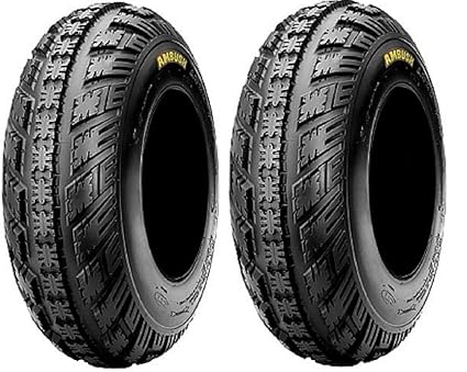

-=Update=-
found this huge Off Road Tire Inner Tubes ($35)
and in HD found this foam boards 4'x8'x2" @ $22.98=tax
the tire tube idea seems to be fading away...
now calculate how many boards i need for our boat (im filling every corner)
