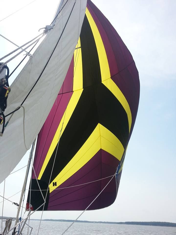

I bought a great spinnaker from JudyBSails last year. I didn't have the funds for any sort of launch bag system so I got just the sack that came with it.
This year, I'd like to add a sock for making the launching and snuffing easier and faster. I couldn't find any links on their site. For those of you with the 26M, does anyone have a sock for your chute? If so, how long is it and where did you get one?

This is beene's boat, but mine (on the port side of beene's) has the same Chutescoop. You can see how much is hanging out. Not a problem in light air, but I like to use mine in a little more of a breeze than that, and it can get hard to control with that much sail hanging out the bottom of it.

Ah, here's the one I was looking for. Wresting with the Chutescoop, which kept lifting while I was trying to douse it and get it under control. It had gotten a bit breezy for such a light sail.
Photo also taken from Crikey, as I obviously didn't, and they (Ross and Gabe) took a lot of good pics at the MMOR IV.

Nice pic!
The snuffer should be just a little shorter than the leech of the asymm. The leech is 24.5 feet. I suggest a snuffer about 23- 25' long, depending on how it's built at the head. I am not very familiar with the chute scoop. 20' would be a bit too short.
