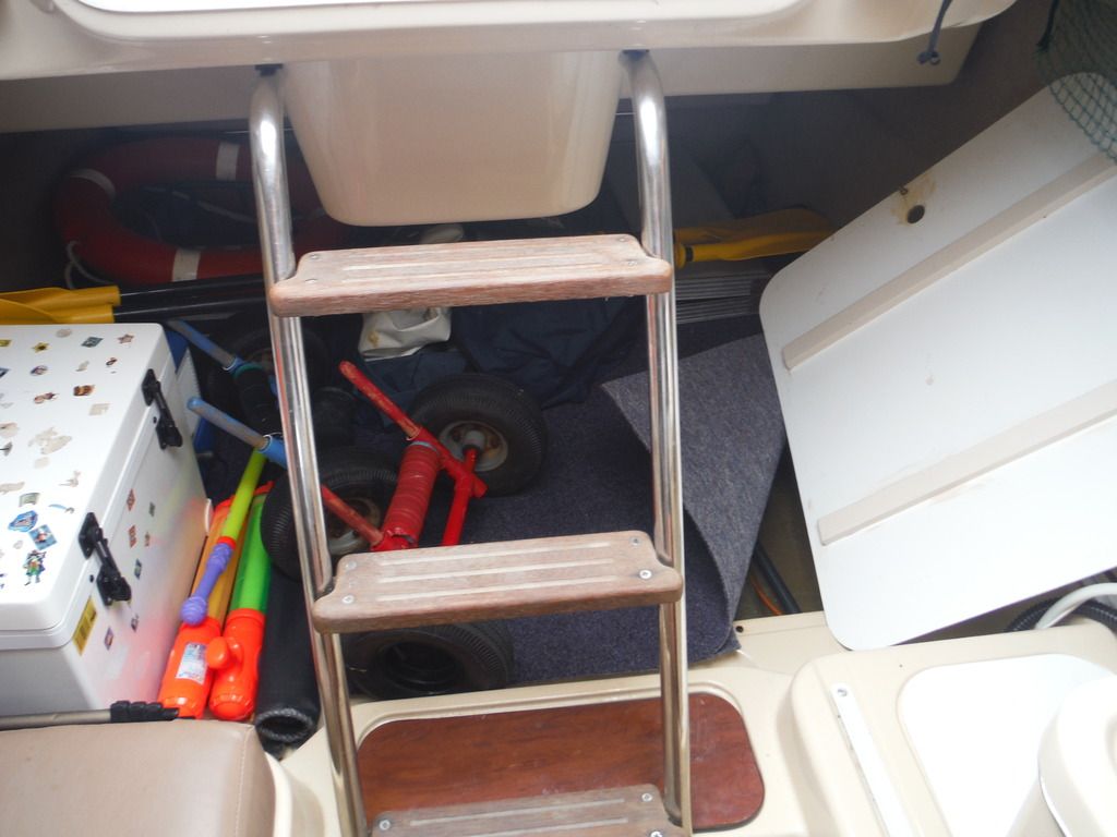

In the stern berth, I use an outdoor carpet which I scored from work. We don't keep the mattresses in the boat anymore as the pizza oven is only a storage area for us now.
And while we are in the stern berth, one problem is that those horrible hatch covers are not strong enough and fall in, and a second problem is that they move around. Some guys use hook and loop stuff and other fixes. As you can see, my fix for both issues is some lightweight cheap pine batterns that I have glued and screwed onto each cover. This gives heaps more strength and stops the sideways movement. WIth the carpet on top, its all good in there.
