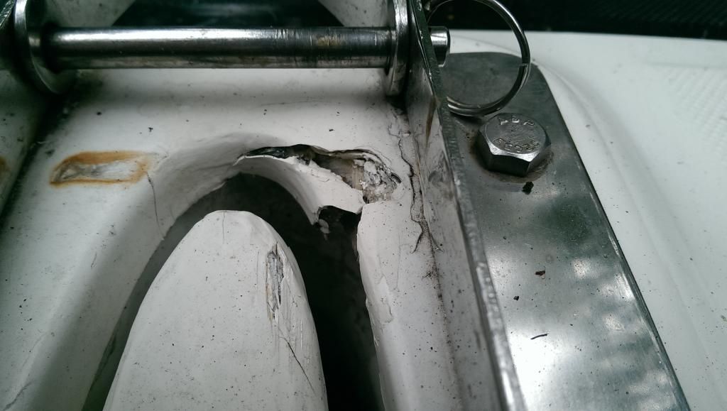

I am not sure how similar my problem is but I am curious on opinions on what to do (I cannot get answers out of BWY or MacGregor (factory Sales - my dealer)). My mast brackets are installed off center so the mast foot rests such that it has broken a section of the deck away.
Wondering if I need to cut a recess in the deck and install a metal plate. or even cut new deck brackets to center the mast.
