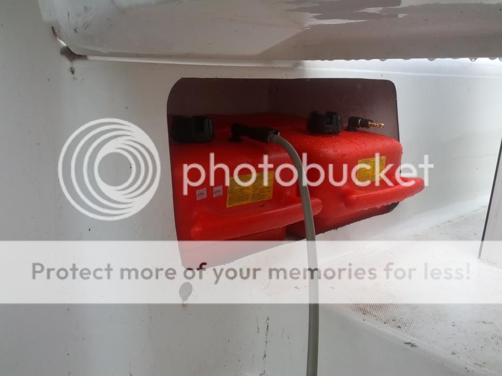

I'm not sure there is a specific "factory" opening.
When I got my boat there was only one 6gal tank per side. After spending time on this site I thought I'd put them both on one side but they wouldn't fit.
I checked and checked for reasons, then I just opened up the face a bit. Before I started I could see that the edges weren't machine straight and the corners weren't very round, it looked like they had been cut or trimmed by hand. Opening them up more and moving the tanks around gave me so much more cockpit storage I regretted not doing it earlier.
Now I've added a third 6gal tank and still have more useable space than I did before with the undersized openings. Cover your skin and use a vacuum and dust mask while you cut.
Willy
Willy

Re: Fuel tanks
I hope I haven't overstated my fuel capacity. I run 2 tanks on one side and one on the other. Originally I couldn't put both tanks in one locker. I opened then up with a hand file hoping that would keep the dust down. About an hour or so to get them to fit. The new tanks are Neptune 6 gallon. They are very easy to get in and out. The old tanks are mercury quicksilver with top handles that have been cut down, they're not so easy in and out with tank vents opposite connectors making switching and opening vents tricky. One quicksilver tank is out of commission with a broken fuel connector. I think I'll stay with 6 gallon tanks as I can go up or down in fuel capacity depending on the length of the cruise. They're also easy to transport allowing me to avoid expensive fuel docks when there's a gas station near by or a vehicle going to town. Here's pics
Willy
Willy
Re: Fuel tanks
Thanks, that's useful. I have a pair of these 6 gallon Scepter tanks, which are slightly different than yours, but I'm sure they're original and therefore much older. I'd like to be able to do exactly what you've done, for extended range when it would be handy.
