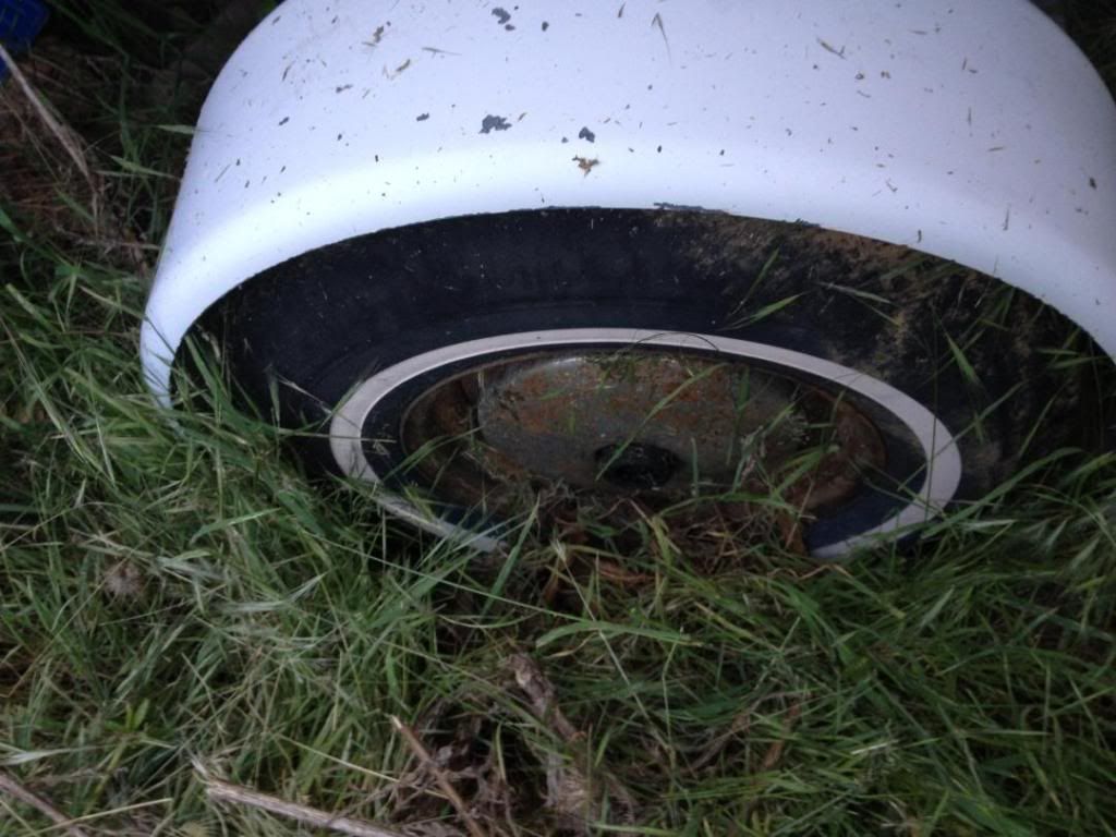

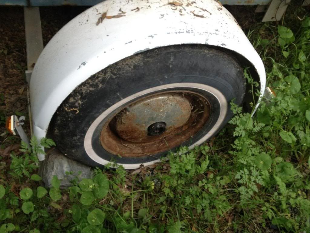

So here are the only 3 photos I have at present...
Can't really make out the trailer very well in this overall shot. But it looks pretty clean to me.
Looking at the photo below, I can't imagine the trailer tongue being much higher than 14 or so inches.
Here are the wheels... they look like they may be originals too, lol. I will just replace them outright!
I will defiantly bring a grease gun!

White wall tires look scary. Did they every make white wall trailer tires? Maybe they do, but the wheels look so rusty, I'm sure the rubber is rotted. I wouldn't take that on the highway.

That's not an original trailer. Roller bunks and bow support are not original, and it looks galvanized, though that could be deceiving. Wheels are automotive style, with old-school wheel cover with the hole in the middle for grease access (my Aquarius original trailer had the same thing). Tires are from a car (whitewalls) - not something you want on a boat trailer. I don't know if the offset of those wheels is the same as with the common 8-spoke design used these days, but you won't know for sure what they are (diameter and stud pattern) until you get there.

This is what's on there now, with the three 'bumps' to hold the wheel cover . . .
. . . but this is what's most common these days (painted or galvanized), and they're a bit cheaper, too.

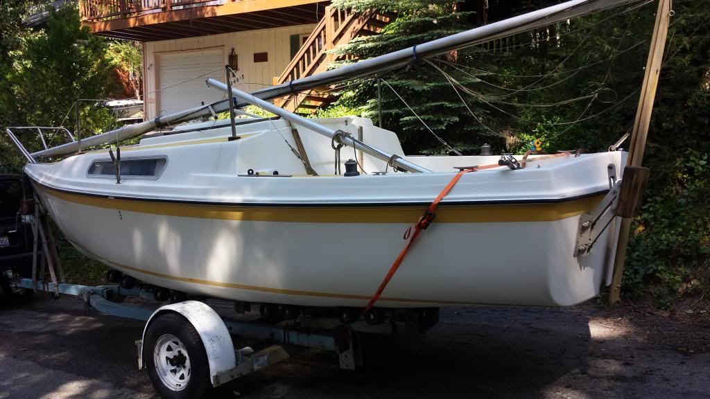

Got her home and cleaned up. I ended up replacing the tires and wheels which on my EZ-Loader trailer were P205/75D14 with a 4 & 1/2, 5-hole pattern. The hitch turned out to be approx 18" with a 2" ball. Not too much rust. Greased her up with marine wheel grease and took her home at 60 MPH tops without any problems. Now I just need to get to work restoring her! Gonna start by panting the trailer and putting on LED trailer lights.
