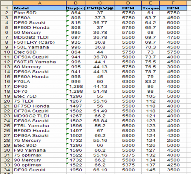

While branching the discussion off to torque I am curious how the torque over the rpm range comes into play with our boats. I notice some motors produce full torque much earlier than others. The merc 75 4 stroke produces full torque at only 2500rpm.
I pulled the following data from the EPA excel spreadsheet of the motors they test. I am guessing the torque numbers are without any gear manipulation, so should be a straightforward comparison. I thought it was interesting that pretty much all models were basically right on their hp ratings but torque can vary quite a bit. The yamaha F70 has way less torque than some of the other 70s and the 75 optimax has more torque than most 90s.

What's interesting about that spreadsheet is that some engines have a very wide power band, like the Optimax 75, which develops full power at 4000 rpm (73.9 hp), while rated power and speed is up at 5375 rpm (74.1 hp), while the Etec 50D develops full torque at full speed (49.6 hp at 5750 rpm). Doesn't say much about the shape of the torque curve, but it's interesting nonetheless.
Oh, and those torque figures are in newton-meters, and taken at the crankshaft, though possibly through the gear train to the prop shaft with the ratio then divided back out. Since outboard powered is determined at the prop shaft, those losses, small though they may be, I would think would be included in the EPA calcs.
I couldn't find the spreadsheet in the screen shot, though. I get a different spreadsheet from the EPA site in the link. :?
The screenshot is of motors commonly used on macs off the epa charts I pulled awile back when I was shopping, you are right the torque is Nm, torque is on the models tab at the bottom.
