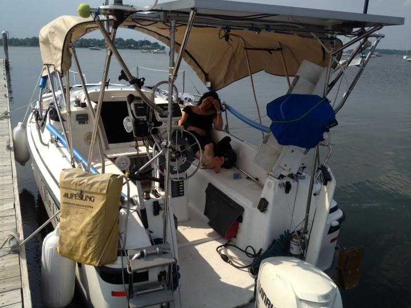

We have been traveling and living aboard our :macx: for three months now . We left Montgomery Ala April first and are sitting in Crystal River as I write .
We are seriously considering removing our mast . We just aren't using the sails , like I thought we would . To put the main up involves going on deck in a rough Gulf . Joanne and I are not as agile as we once were and I worry about us going over the side, while working on the main sail . We use the jib sail quite often simply because its on a furler and we can control it from the cockpit , so we motor sail often .
Often the winds aren't favorable and I can't see tacking when I got a perfectly good Honda , back there .
Got a question ,, with no mast , would it be necessary to fill the ballast ? Would the boat be stable with no mast and no ballast ?
We retired and cruising on a small budget and want the maximum efficiency . If we aren't using the mast then there is no sense in having it aboard . The motor would get better gas mileage without it and the ballast .
I think really we are trawler people at heart more so than sailors .
If I did remove it , I would probably build a decorative mast for an anchor light and flag pole .
Need advice , please .

Gypsy Life
Posts: 33
Joined: Fri Mar 23, 2012 12:16 pm
Location: Montgomery Alabama
Re: Mac Trawler....
Post by Gypsy Life »
Thanks for the replies . Even if I keep the ballast in , the boat out to be more efficient without the mast and rigging .
I have thought about trading my jib sail for a 150% genoa and removing the boom and main .
The idea of a center grabline is a good one .
We have a hardtop over the helm , that holds our solar cells , I could run the line from it , over the stubby mast and down to the bow rail .
We are anchored just south of and near to Pete's Pier . come on by when you are out and about . We will probably be here on July 4th .

fouz
Posts: 214
Re: Mac Trawler....
Post by fouz »
Gypsy Life wrote:Thanks for the replies . Even if I keep the ballast in , the boat out to be more efficient without the mast and rigging .
Would it be possible to post some pics of your boats hardtop?
I have thought about this myself. Adding like a center console boat T-top that would look more like a Bimini.
